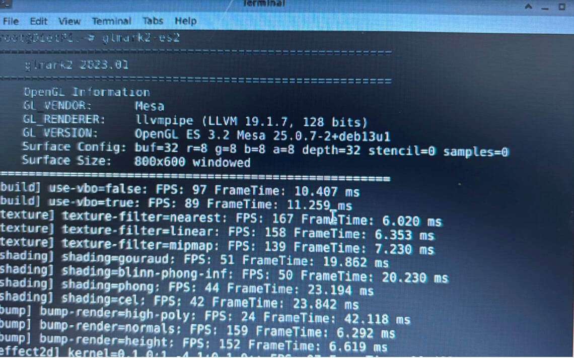

Hi, I checked this on DietPi. For the GPU vendor and renderer, it shows Mesa and llvmpipe. I also tested it using an OpenGL benchmark, but it only got a score of around 80. Because of this, I think the GPU hardware acceleration is not working properly.

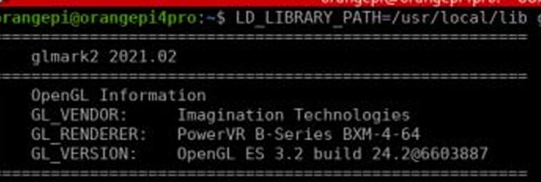

However, when I use the image provided by Orange Pi, it detects Imagination Technologies as the GPU vendor and uses PowerVR B-Series BMX-4-64 as the renderer. When I run the same benchmark, it gets a score of around 500, so I believe hardware acceleration is working properly with the Orange Pi image
That you use LD_LIBRARY_PATH=/usr/local/lib indicates that you do load a custom library from there, which would match my assumption.
Take those + the pvrsrvkm.ko from the path shown in modinfo pvrsrvkm, and it should work on DietPi as well. But also worth testing with Mesa 26 from trixie-backports, as mentioned.
