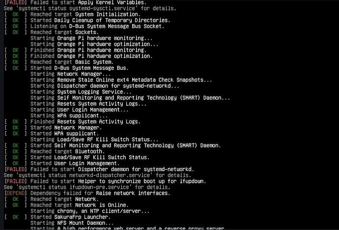

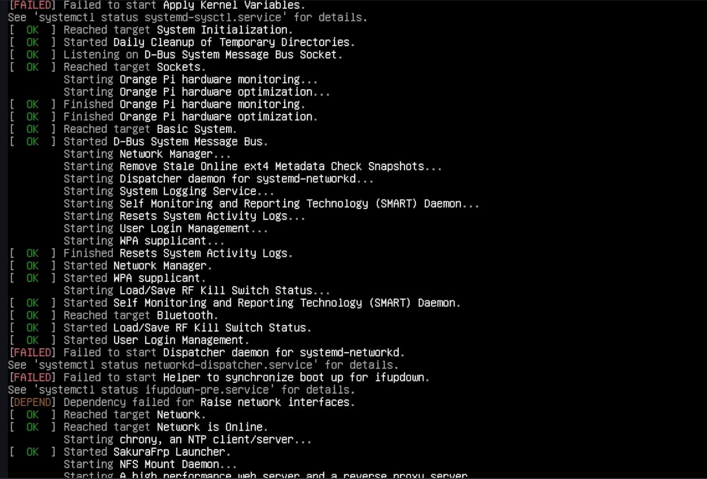

I get several boot errors during startup:
[FAILED] Failed to start Apply Kernel Variables.
[FAILED] Failed to start Dispatcher daemon for systemd-networkd.
[FAILED] Failed to start Helper to synchronize boot up for ifupdown.
[DEPEND] Dependency failed for Raise network interfaces.

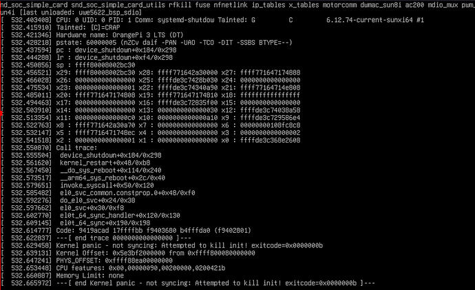

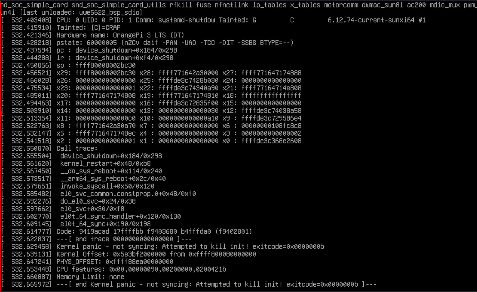

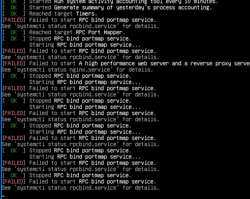

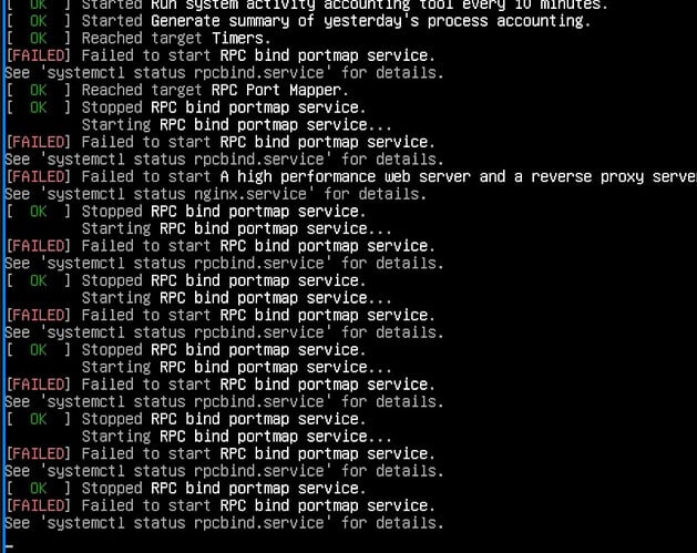

After flashing the image, I plugged it into the motherboard and booted. The LEDs remained a normal green, and there was HDMI output. I used a video capture card to view the screen on my computer using OBS Studio. The device got stuck in the boot process for a long time. The attached file shows the subsequent error message.
Our images do not have Nginx or rpcbind.service preinstalled. Whatever it booted there, it was not the SD card, or our image was not on the SD card. Did it probably boot the eMMC?
After removing the SD card, the system rebooted normally. The eMMC installation was 3.0.8_debian_bullseye_server. After flashing the 3.0.8_debian_bullseye_server system and inserting the SD card, the system also booted normally.

After the automatic reboot, it failed to boot, displaying:
Kernel panic - not syncing: Attempted to kill init
PID: 1 Comm: systemd-shutdown
I was able to boot into the system again after forcibly shutting down and turning the power back on.
Means its working now?
yes
A kernel oops on first shutdown. Same was reported with Orange Pi Zero 3 a while ago: Orange Pi Zero 3 | Kernel oops on first reboot · Issue #7590 · MichaIng/DietPi · GitHub
I was never able to replicate it. Since both are Orange Pi with UNISOC/Spreadtrum WiFi, I tend to believe that the WiFi driver is the culprit, which causes crashes inside other drivers or kernel operations in a few other scenarios. But we do not load it anymore on first boot, unless WiFi is explicitly enabled. This was different before, since some time earlier it caused crashes as well when being loaded via modprobe after boot.
Ah, I see [last unloaded: uwe5622_bsp_sdio] in both logs. So yeah, my guess was right. Just weird that it crashes only on first shutdown :thinking:.
Simply horrible this driver, I hope Xunlong never uses a UNISOC chip ever again in their SoCs.
