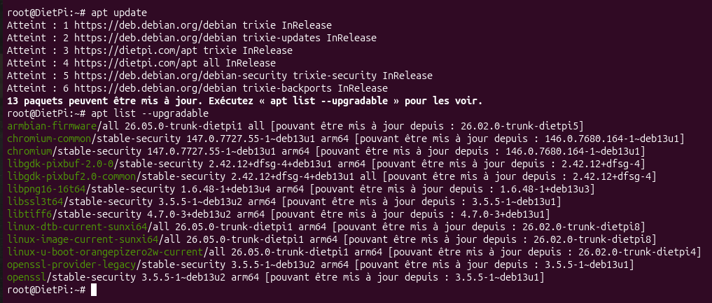

I start from the DietPi v10.2.3 and apt update and the list upgradable below
I try to fix with the tips mentionned by Torben without success
So the last functionnal kernell with eth0 is below

@Totof before I adjust the patch, can you verify by loading the respective driver manually?
lsmod # verify that dwmac-sun8i is not loaded.
modprobe dwmac-sun8i
ip l
EDIT: I just see that the sunxi-gmac driver is still patched into the kernel: https://github.com/armbian/build/blob/ef5966af47bda682e68555c120df3429fa253bae/patch/kernel/archive/sunxi-6.18/patches.armbian/drv-net-stmmac-sun8i-add-h618-emac.patch
But it is not enabled anymore in the Linux 6.18 kernel config. So if the mainline driver does not work, or does not work well, we can instead test to enable CONFIG_SUNXI_GMAC=m, like it was the case with Linux 6.12. But I’d prefer a mainline driver over a patched driver, and whether it actually compiles on Linux 6.18 is also uncertain, since obviously this has never been tested.

Did you run
AFAIK it is not possible that a module is not loaded without any kernel or console error about it. Ah, or it contains underscore instead of dash:
lsmod | grep dwmac_sun8i
Right, there is always this inconsistency between module name in code => name.ko, and what lsmod returns with all underscore.
The kernel build finished, hence you can test it with
G_DEV_TEST_FIRMWARE
