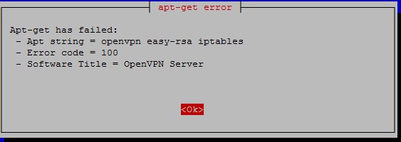

I tried to install openvpn (twice) and I have the following problem.
I’m running the v101.
I don’t know if the problem is coming from me o there is something wrong in the script.
Than you in advance for your help
Hi Agox,
Thanks for the report.
Can you try running the following please:
rm /DietPi/dietpi/.dietpi-apt-get_update
killall apt-get
/DietPi/dietpi/dietpi-apt-get_update 2
Then try running dietpi-software and selecting OpenVPN again:
dietpi-software
Let me know what happens. Thanks.
Hi Fourdee,
after your steps, the installation did work. Thank you
Now I have to check if OpenVPN works.
Thanks Agox.
