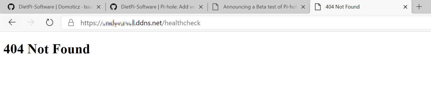

The error that I receive is this one:
"Error when trying to connect (Client error: GET https://XXXXXXX.ddns.net/healthcheck resulted in a 404 Not Found response: <?xml version="1.0" encoding="iso-8859-1"?> <!DOCTYPE html PUBLIC “-//W3C//DTD XHTML 1.0 Transitional//EN” “htt (truncated…) )”

I don’t think this is something we can help with. As you can see, your application is trying to connect to a website https://xxxxx.ddns.net/healthcheck
Client error: `GET https://xxxxx.ddns.net/healthcheck` resulted in a `404 Not Found`
And this website is not available. I see you adjusted the original post. however i tried with the real link and got the same message 404
Edit: https://xxxxx.ddns.net/ is reachable. so it’s your sub-folder healthcheck that did not seems to exist
