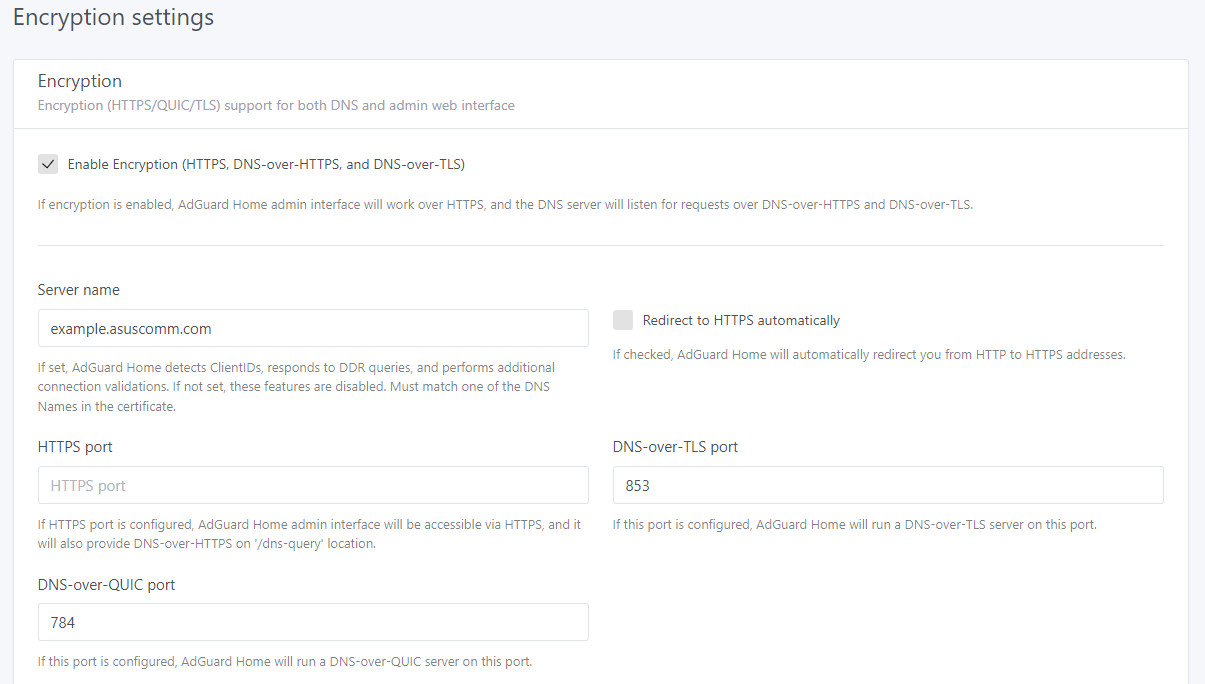

But how setup this ports:

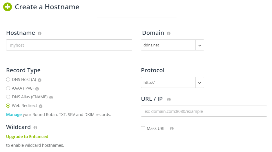

And now I’ll hide this address for nextcloud.
Should be enough to masked https:// sample.asuscomm.com/nexctcloud by https:// example.noip.biz

Honestly I don’t understand what you are trying to do on your screenshot.

For proper blocking, tiktok have to be setup encryption DNS-over-TLS because, many softwares can escape from blockade using TLS…
So on this screen https port I can use 8083, I think so.
By masking i mean do not share my main domain, asuscomm.com/nextcloud but for example
https:// myclous.noip.biz
what should be the goal of this? Are there clients/devices that should connect to AGH using DoT? Or should AGH connect to upstream DNS using DoT? Maybe try to describe the solution a little more on what you are trying to achieve.
HTTPS port is 443.
8083 is the HTTP port of AGH. SSL is done by Nginx now and not by AGH anymore.
