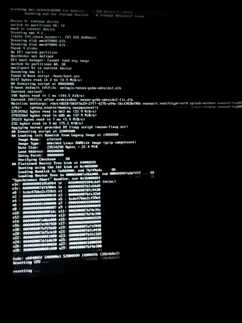

  • Error received = mmcblk0: unable to read partition table

  • Cycle power, see repeating error during boot → mmcblk0: unable to read partition table

  • See repeating error again during boot → mmcblk0: unable to read partition table
Boot log fresh SDcard with fresh install: OdroidC2-Boot_Error - Pastebin.com
Boot log of original SDcard with upgrade: OdroidC2-Upgrade_Error - Pastebin.com

:sparkler: I found my own solution. :sparkler:
The fix: Revert meson-gxbb-odroidc2.dtb back to ‘dtb-6.6.32-current-meson64’ version.
The explanation:
The DTB in v9.6 appears to included the following fix to a reboot issue. See link below
The link describes and the DTB in the v9.6 includes the following GPIO device tree gpios input updated
gpio-regulator-tf_io {
                compatible = "regulator-gpio";
                regulator-name = "TF_IO";
                regulator-min-microvolt = <0x1b7740>;
                regulator-max-microvolt = <0x325aa0>;
                gpios = <0x39 0x03 0x00>;
                gpios-states = <0x00>;
                states = <0x325aa0 0x00 0x1b7740 0x01>;
                vin-supply = <0x3a>;
                phandle = <0x28>;
gpios = <0x39 0x03 0x00>; becomes gpios = <0x39 0x03 0x06>;
0x00 → 0x06
On my device, this was preventing the device to from boot from the SD. I don’t know why. Reverting the line back to 0x00 fixes the problem.
In my case I took the original SDCard and manually copied the meson-gxbb-odroidc2.dtb file from the DietPi_OdroidC2-ARMv8-Bookworm.img.xz image onto the SDCard
Since no one else reported any issue with this reboot fix: Could you try to revert only his one change in the device tree, otherwise use the very same kernel? Probably it is another change, not that one.
I initially verified by taking the v9.5 image DietPi_OdroidC2-ARMv8-Bookworm.img.xz and not making any updates. That image I am unable to reboot with the roboot command, but with a power cycle the unit will boot just fine.
I took that image and made only the DTB reboot fix update (changing 0x00 to 0x06). With only that change, I was unable to boot after a power cycle. mmcblk0: unable to read partition table error
I went back to a fresh v9.5 image but this time I did a apt update && apt upgrade; the new DTB is loaded. Before rebooting or power cycling, I reverting the DTB reboot fix (reverting 0x06 to 0x00). Power cycled and the unit boots.
I took the upgraded image and update the DTB (0x00 to 0x06) and power cycled; unable to boot.
The original SDCard that had been upgraded from v9.5 to v9.6 would not boot until I reverted the DTB. Once reverted, I can boot from the SDCard without issue and running v9.6. reboot command still doesn’t work, but I can live with that.
