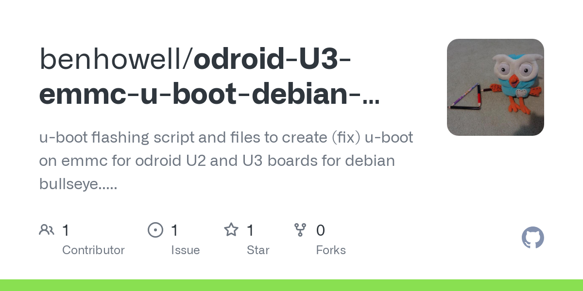

I was looking into this solution but the script fails.

I came across these instructions to get Arch Linux on the eMMc to boot:
eMMC Module Creation
Attach the eMMC module to the micro SD adapter, and plug that into your computer.
Follow the above steps to install Arch Linux ARM, and boot the board with the eMMC still attached to micro SD adapter, plugged into the SD slot in the board.
Re-flash the bootloader to the protected boot area of the eMMC module:
cd /boot
./sd_fusing.sh /dev/mmcblk0
Power off the board:
poweroff
Remove the micro SD adapter, detach the eMMC module, and connect the eMMC module to its connector on the board.
Re-apply power the board.
