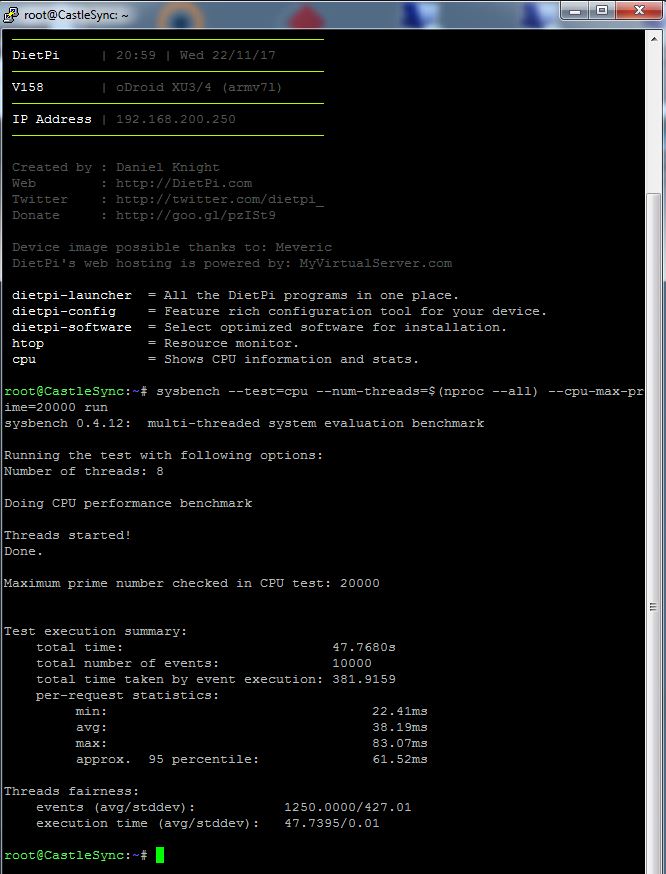

  1. SysBench
    Interesting result, when i compare it with the results of XU4 in another thread here in the forum.

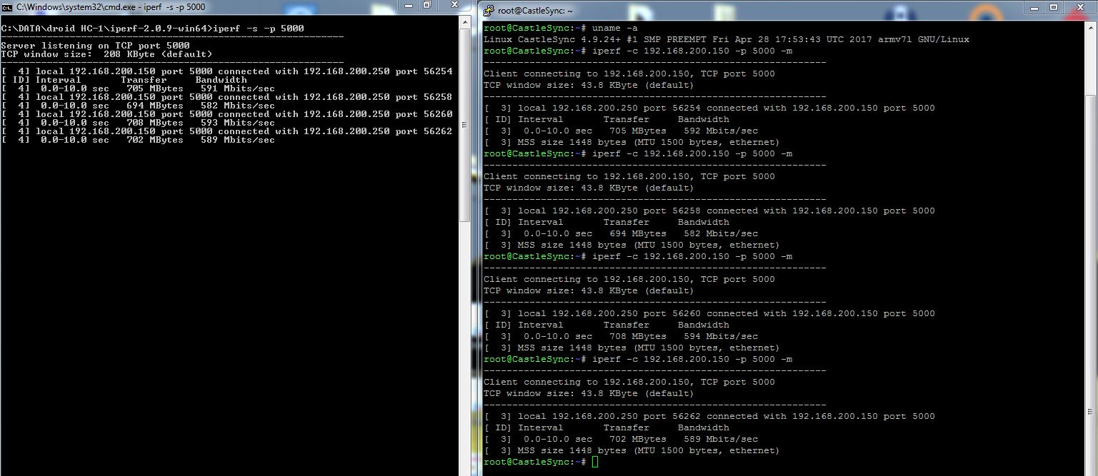

  2. iperf - first run (Server side = W7 x64 Iperf 2 / Gbit USB 3.0 Adapter) (Client Odroid HC1)
    If anyone have some further interesting tests i could do, just tell me, so far my freetime allowes it, i’ll test it.

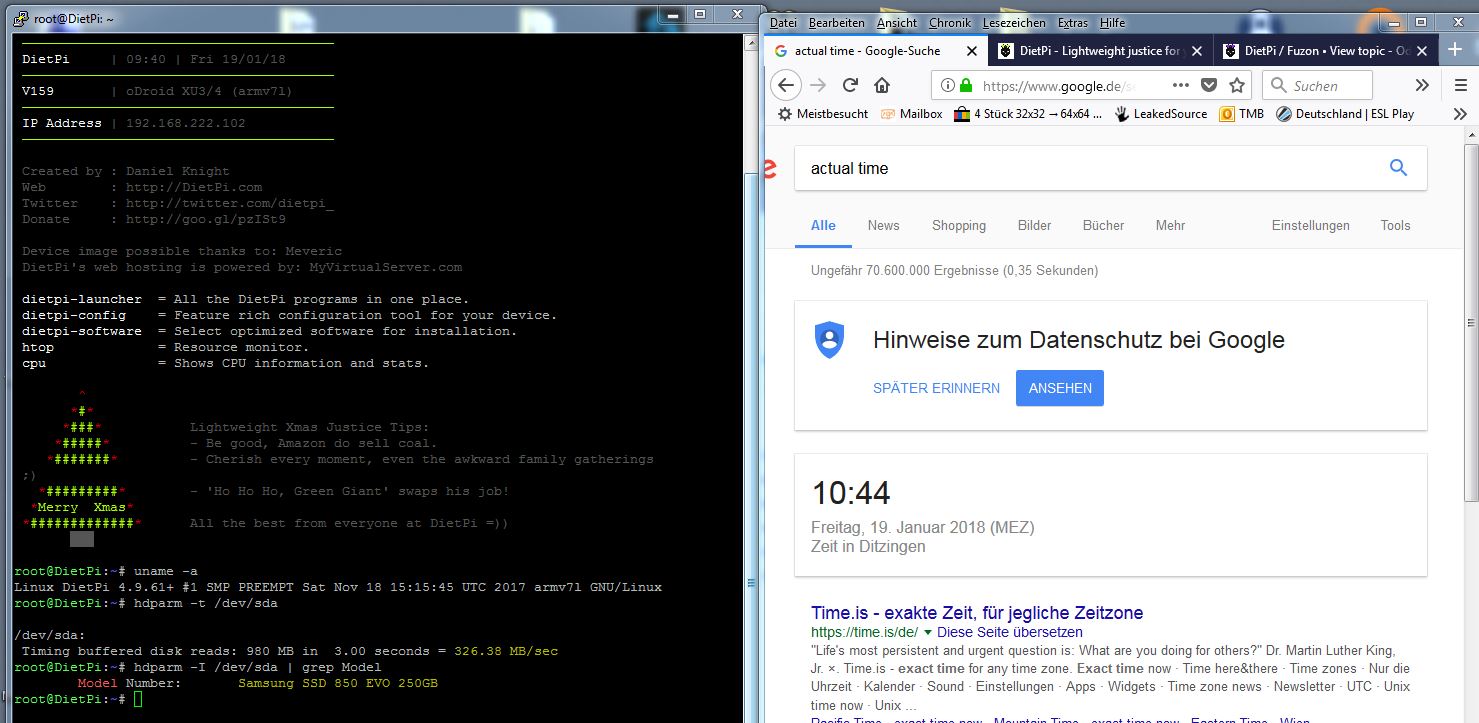

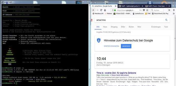

Sure, I have a test for you. I’d like to know what kind of hard drive speeds you are able achieve with “hdparm -t”. If your 2.5" SATA disk, is, say, “/dev/sda” (in DietPi), then what output do you see (when the system is idling quietly) with:
hdparm -t /dev/sda
(You probably already know this, but in case you don’t, the “mount” command should give you output which lets you deduce which device file is the SATA drive.)
Test result:
Note:
The Sata Controller is connected via USB 3.0 not 2.0, so you have a theretical max of about 625 MB/sec. (5Gbit/s), therefore
i have placed in a Samsung 850 SSD (about 550MB/s), the practicaly test shows a value of about 326 MB/s in reading mode.

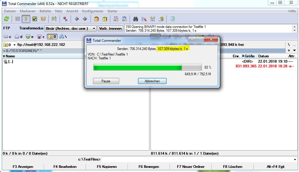

From you context you had the same problem then me before using Odroid XU4 oder HC1, at moment i am testing my HC-1 in a business installation, making backups of about 1.000.000 files with a space amount of about 750 GB. Right now it works faster then mostly NAS, which i saw in the past, and the 90 Mb/s are realistic on large files.
My big problem was in the past, that also quality NAS System mostly are do not more then 25-45 MB/s over LAN, with Odroid HC1 i could solve this issue.
Further you should not compare the odroid hc1 with a real fileserver (IBM/HP/DELL/etc), as this is another league, but as NAS with nice fast transfer, it works very well and is cheap on top.

FTP-Speed - large file @ Samsung SSD
