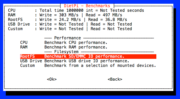

Just some tests, to get clear, what setenv disableuhs “disableuhs” in /boot/boot.ini do:
 DietPi     | 14:30 | Tue 12/12/17
 V159       | oDroid C1 (armv7l)
 IP Address | 172.16.10.206
 Created by : Daniel Knight
 Device image possible thanks to: Meveric
 DietPi's web hosting is powered by: MyVirtualServer.com
      *###*           Lightweight Xmas Justice Tips:
     *#####*          - Be good, Amazon do sell coal.
    *#######*         - Cherish every moment, even the awkward family gatherings ;)
   *#########*        - 'Ho Ho Ho, Green Giant' swaps his job!
  *Merry  Xmas*
 *#############*      All the best from everyone at DietPi =))
root@oDroid-C1:~# cat /etc/.dietpi_image_version
144
root@oDroid-C1:~# cat /etc/debian_version
8.10
root@oDroid-C1:~# uname -a
Linux oDroid-C1 3.10.104 #1 SMP PREEMPT Thu Nov 10 07:56:43 CET 2016 armv7l GNU/Linux
root@oDroid-C1:~# cat /proc/cpuinfo | grep -iE "(Hardware|Revision)"
CPU revision    : 1
Hardware        : ODROIDC
Revision        : 000a
root@oDroid-C1:~# cat /boot/boot.ini | grep "disableuhs "
setenv disableuhs "disableuhs"
root@oDroid-C1:~# dmesg | grep sd
[    0.000000] Kernel command line: root=/dev/mmcblk0p2 rootwait ro console=tty0 no_console_suspend vdaccfg=0xa000 logo=osd1,loaded,0x7900000,720p,full dmfc=3 cvbsmode=576cvbs hdmimode=720p m_bpp=16 vout=hdmi disableuhs disablehpd=true
[    1.204875] aml_sd_voltage_switch[1309] : Switched to voltage -> 3.30 V
[    1.261476] sd: mmc_rescan_try_freq: trying to init card at 400000 Hz
[    1.321435] [aml_sdhc_probe] aml_sdhc_probe() success!
[    1.442397] sd: new high speed SDHC card at address aaaa, clock 38636363, 4-bit-bus-width
[    1.445473] mmcblk0: sd:aaaa SU04G 3.69 GiB
[    1.451441] [aml_sdio_probe] aml_sdio_probe() success!
## setenv disableuhs "disableuhs" ##
[    0.000000] Kernel command line: root=/dev/mmcblk0p2 rootwait ro console=tty0 no_console_suspend vdaccfg=0xa000 logo=osd1,loaded,0x7900000,720p,full dmfc=3 cvbsmode=576cvbs hdmimode=720p m_bpp=16 vout=hdmi disablehpd=true
[    1.181687] aml_sd_voltage_switch[1309] : Switched to voltage -> 3.30 V
[    1.241156] sd: mmc_rescan_try_freq: trying to init card at 400000 Hz
[    1.301089] [aml_sdhc_probe] aml_sdhc_probe() success!
[    1.431086] [aml_sdio_probe] aml_sdio_probe() success!
[    1.442139] sd: new high speed SDHC card at address aaaa, clock 50000000, 4-bit-bus-width
[    1.442508] mmcblk0: sd:aaaa SU04G 3.69 GiB
root@Odroid-C1:~# cat /boot/boot.ini | grep "disableuhs "
root@Odroid-C1:~# dmesg | grep sd
[    1.205150] aml_sd_voltage_switch[1309] : Switched to voltage -> 3.30 V
[    1.261612] sd: mmc_rescan_try_freq: trying to init card at 400000 Hz
[    1.321582] [aml_sdhc_probe] aml_sdhc_probe() success!
[    1.412963] sd: new high speed SDHC card at address aaaa, clock 38636363, 4-bit-bus-width
[    1.416037] mmcblk0: sd:aaaa SE32G 29.7 GiB
[    1.451588] [aml_sdio_probe] aml_sdio_probe() success!
### setenv disableuhs "disableuhs" ###
[    1.169169] aml_sd_voltage_switch[1309] : Switched to voltage -> 3.30 V
[    1.231289] sd: mmc_rescan_try_freq: trying to init card at 400000 Hz
[    1.291267] [aml_sdhc_probe] aml_sdhc_probe() success!
[    1.363347] aml_sd_voltage_switch[1309] : Switched to voltage -> 1.80 V
[    1.399252] sd: new ultra high speed SDR104 SDHC card at address aaaa, clock 94444444, 4-bit-bus-width
[    1.402348] mmcblk0: sd:aaaa SE32G 29.7 GiB
[    1.421270] [aml_sdio_probe] aml_sdio_probe() success!
