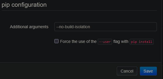

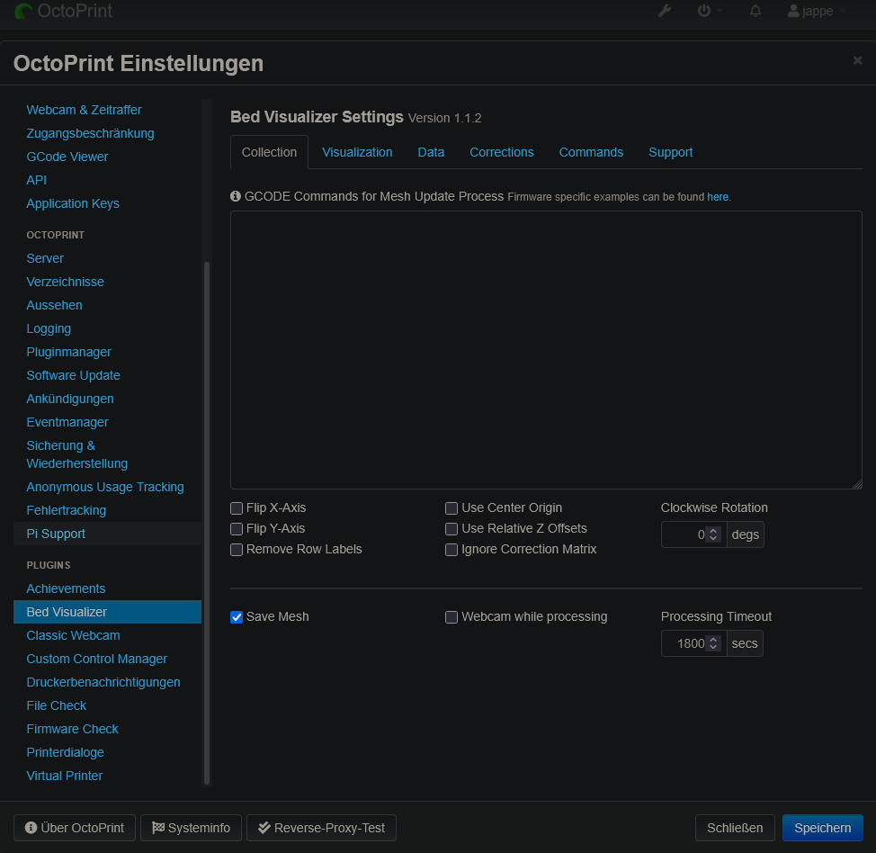

screenshot
I found a solution without fiddling with the service file (but maybe it would be a good idea to install it in it’s own virtual environment in the future)
You need to set the --no-build-isolation flag in the plugin manager settings.
With this settings you can install it via the web panel.
Unfortunately, if you wanna delete it via web panel, it also uses --no-build-isolation for the removal, but this will not work. So before deinstallation you need to clear the Additional arguments field. All of this hassle can be avoided when using a virtual enviroment, I will have a look into that, but not today :slight_smile:

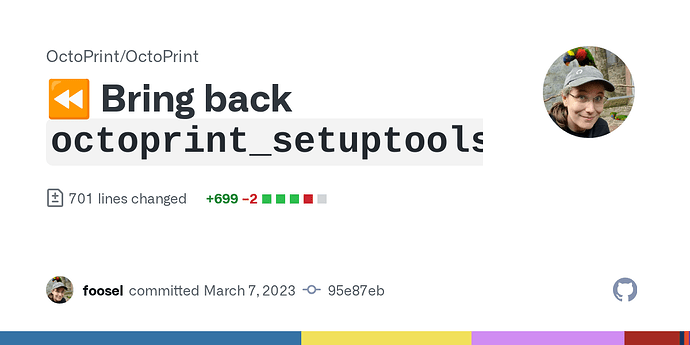

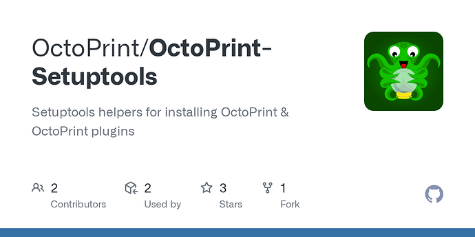

Checking the plugin: It uses old standards indeed, and the error is not coming from setuptools but some dedicated octoprint_setuptools indeed:
There were some issues around this in the past:
So right now, OctoPrint itself provides it internally:
For now to me it looks like an issue with the particular plugin, trying to load octoprint_setuptools without declaring it as build dependency. Makes sense that it is not available in the isolated build environment then. Let’s see how other OctoPrint plugins handle this.
