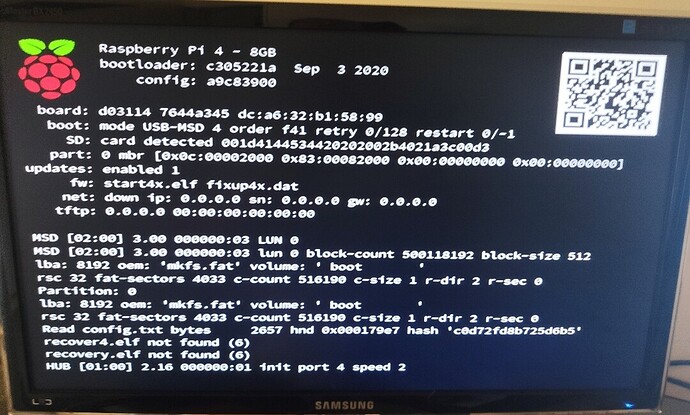

pls can you connect a screen to your RPi and check what happen during boot.
looks like boot partition is corrupted and/or missing data.

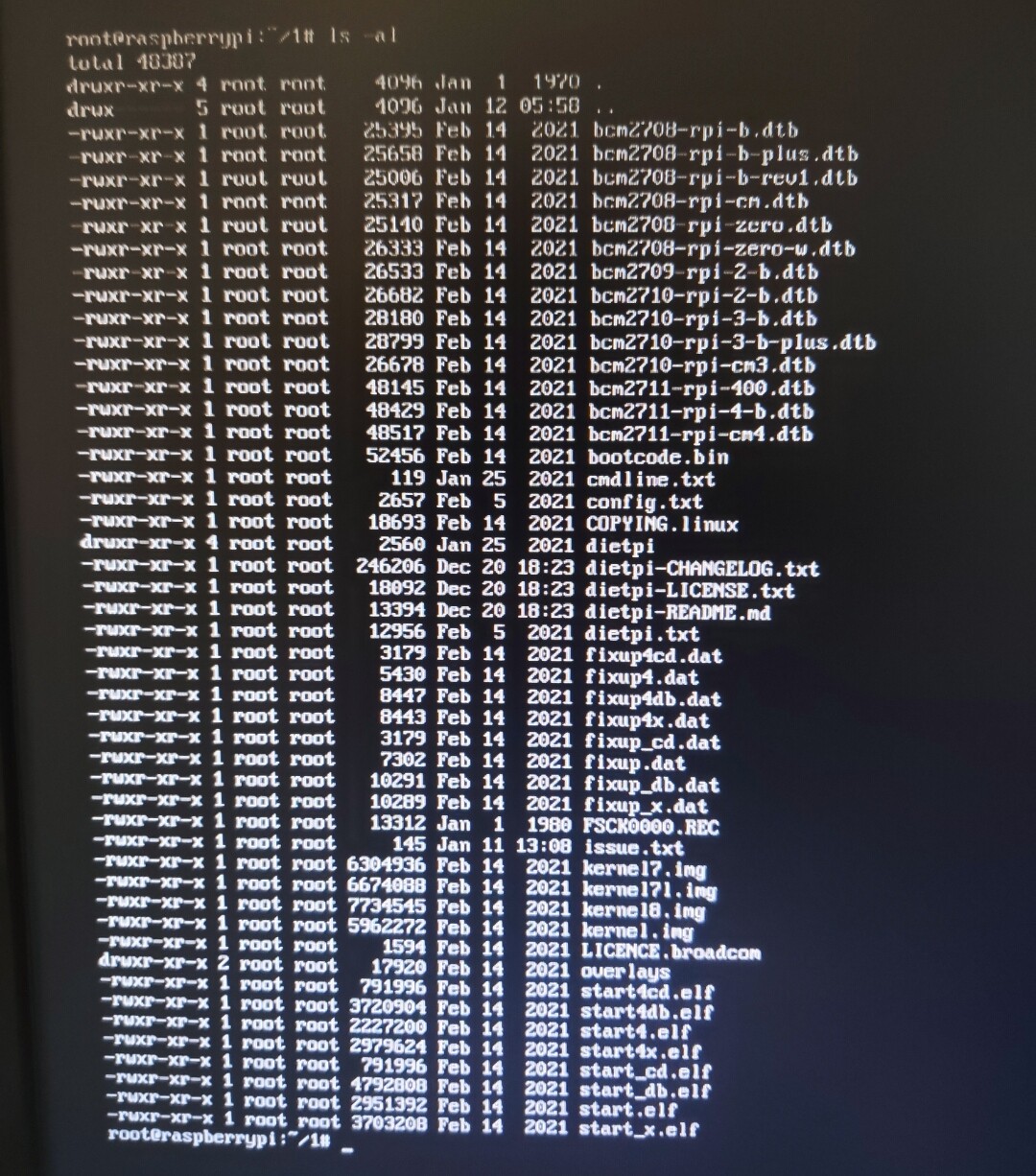

It fails before even invoking the root partition, so something in in the boot/FAT partition seems to be missing or broken. Can you paste the whole content of it, via ls -al /mnt/sdb1 respectively the actual mount point.
i didn’t do any updates…i will attach a photo of the files.
Attached

Can you show the content of this FSCK000 file? In case the first few lines would be enough.
From what I see all required file are present with valid metadata. Do you load any dtoverlay, i.e. is there a related line in config.txt and is the related dtbo file present in /boot/overlay/? Although a missing overlay should not prevent boot.
Here are the files that match your kernel version btw: https://github.com/raspberrypi/firmware/tree/8572bb50bf24a9ffef949ced69776e66559f4afe/boot
At least as long as you didn’t use rpi-update manually. So we can try to manually replace all files from there, at best from an external host.
Also as a failsafe step, you could do a filesystem check on a Windows machine, which AFAIK deals with FAT partitions better than the dosfsutils for Linux.
