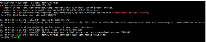

Hey there.
I too am facing an issue with my nord vpn setup. I mistakenly edited and saved the up stream script file and reverted it back later.
the error i get when i check the status is that is i do not have the permission.
I have attached the error message.
Thanks
pls can you post following
ls -la /var/lib/dietpi/dietpi-software/installed/dietpi-nordvpn
