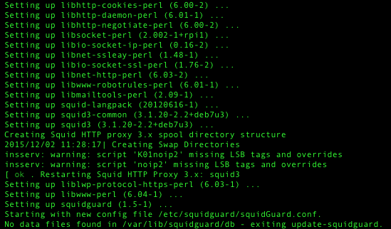

I’ve installed squid on my DietPi Wheezie RPI2B, and i’ve seen these warnings (image attached).
I installed this morning, too, a fresh DietPi Wheezie image, with SSH, VNC and NoIP (that’s all).
The messages:
insserv: warning: script ‘K01noip2’ missing LSB tags and overrides
inssserv: warning: script ‘noip2’ missing LSB tags and overrides
Have I done something wrong?
I have to say that last week I installed DietPi Wheezie on my first RPI, a 1 B 512 MB RAM and everything worked like a charm. Yesterday I tried to install DietPi Jessie on my recently bought RPI 2 B, and I couldn’t go into xxxxx.ddns.org from “the outside” correctly: it just worked for 5 minutes, and I had to reboot the RPI2B calling to my wife, then again it (noIP) worked for 5 minutes, and then another phone calling! For this reason, this morning I went back Wheezie and, although NoIP seems to work perfectly (now SSH connected and with no need to phone call to home), I’ve got these messages.
Thank you very much for your help,
Oscar

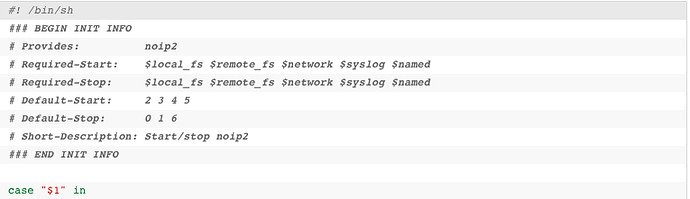

There’s a post that says the (supposed) solution: http://www.lawebdelprogramador.com/foros/Linux/1481798-solucionado-insserv-warning-script-noip2-missing-LSB-tags-and-overrides.html

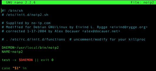

It says adding on /etc/init.d/noip2 these lines on the beginning of the file:
In the DietPi /etc/init.d/noip2 we have:
The rest of the file is the same.
Do I do this? I’m newbie on Linux Servers and I don’t want to mess with it up!

Hi Skyfly555,
We pulled the noip service file from the noip website.
Yep this should be fine, the only changes I’ve made are added dietpi-service and moved $syslog to “should”. Syslog is not installed on DietPi systems unless you use “full logging mode”.

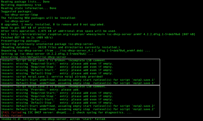

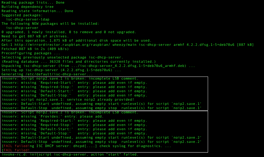

I’m installing new things just to get a proxy-firewall working on my RPI2B.
Now, installing a DHCP Server (apt-get install isc-dhcp-server), I’ve got more error messages (image attached):

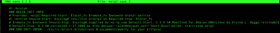

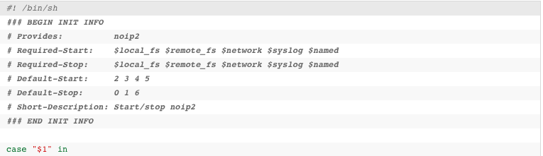

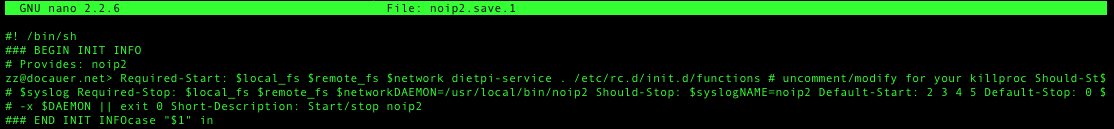

I suppose this is related to the changing of headers we have done before on the file “/etc/init.d/noip2” because the “INIT SECTION” in the file /etc/init.d/noip2.save.1 seems a little messy (image attached):
So, what do I have to do? Taking the “init section” of the file /etc/init.d/noip2 and copy it “as it is” to the files /etc/init.d/noip2.save.1 and /etc/init.d/noip2.save.2?
Note: The file /etc/init.d/noip2.save.2 seems not to be so messy, but neither in a good condition (image attached):
Thank you,
Looks like a formatting issue when you pasted into the terminal. Try clicking “select all” in the code box, copy, then paste directly into the terminal.
Lets download the updated NoIp service from DietPi v102:
wget https://raw.githubusercontent.com/Fourdee/DietPi/testing/dietpi/conf/noip_init -O /etc/init.d/noip2
Then do the following:
chmod +x /etc/init.d/noip2
update-rc.d noip2 defaults
#Disable services so DietPi-services can take control (DietPi will start all services from rc.local during boot)
/DietPi/dietpi/dietpi-services disable
