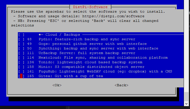

I specifically put DietPi on my Raspi3 to set it up as an owncloud server. Now I do not find owncloud in the list of optimized software?
Am I doing sth wrong? I am using v6.25.3.

Do you specifically need OwnCloud?
NextCloud is there (#114) and is a fork of OwnCloud which for my money an improvement on it too, and works very well.

Which version of DietPi are you running, and on what hardware?
I just checked on mine (Pi 2B running v6.25.3) and I have Owncloud as an option under optimised software (item 47).
try latest version, as I downloaded Dietpi 2 days ago and imaged it, booted in and nothing. i can’t install anything. whenever i select a piece of software it takes me back to the main menu and asks if i want to do a minimal image?
Hey guys, ownCloud 10.3 has just been released, which finally supports PHP7.3. Thus we can now integreate Buster support for it, sadly this came 1 day too late to be part of DietPi v6.26. However I will create a PR with an updated dietpi-software script which you can download to install ownCloud on your Buster system.

If you select software within Optimised Software menu (by hitting space to mark something) and then from main menu select “Install”, it asks you to cancel or do minimal install? This should only be the case if really no software title has been selected from wither Optimised or Additional software menu/list. Please verify that you marked some title, so that it gets an [x], then select [Ok] or hit to accept selection.

Okay, I just created the PR: https://github.com/MichaIng/DietPi/pull/3169
After updating to DietPi v6.26, please try:
wget https://raw.githubusercontent.com/MichaIng/DietPi/owncloud/dietpi/dietpi-software -O /DietPi/dietpi/dietpi-software
This should allow you to install ownCloud on RPi1/Zero and Buster-based systems via dietpi-software.
I will keep this branch active until v6.27 release, since it does not contain any other changes yet, hence is safe to use on v6.26.
