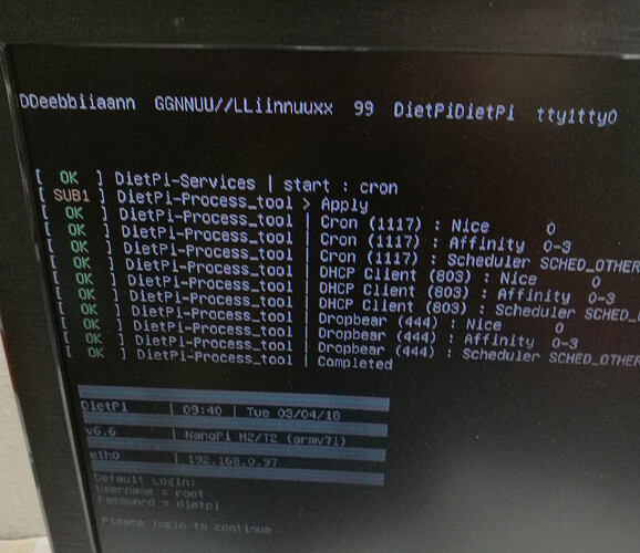

Hi. Have problem with no login prompt on TTY1.
My environment:
board: Nano PI M2A
sd card(s): 32G Sandisk and 8G Hama (same problem for both)
screen(s): X710 7’’ 1024x600 (connected to LCD terminal on M2A board) / LG 32 via HDMI (same problem for both)
build/image: latest (DEC 2017) image DietPi_NanoPiM2-armv7-(Jessie).
After proper boot (boot text appeared) regardless the time of waiting I can see on screen info about default login and info from NTPD and have no login prompt.

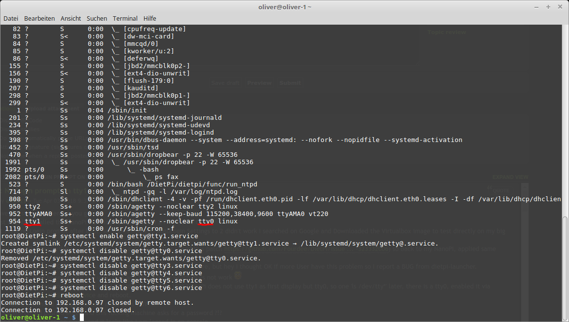

Now I had the Idea to search for the used tty’s and found lsdev which does not work :thinking:
After some more research on Google I had the Idea it could be that NanoPi does not use tty1 as first display but tty0, so one ‘ls /dev/tty*’ later, there is a tty0, enabled it via systemctl enable getty@tty0.service and reboot.
now I saw a command prompt, now my mind goes WTF?!?
I typed startx and pushed enter and this fucking machine asks for a password ?!?
After a minute or 2 screen clears and it looks like I am logged in on console
attached is a screenshot
After some more testing I had some freaky outputs look at attached screenshot :open_mouth:
than i had some illogical outputs at ps fax :roll_eyes:
so i did some commands
systemctl enable getty@tty1.service
systemctl disable getty@tty3.service
systemctl disable getty@tty4.service
systemctl disable getty@tty5.service
systemctl disable getty@tty6.service
and a reboot
Now LXDE starts like it should :smiley:
I don’t know why it did not start before, but hey it works
