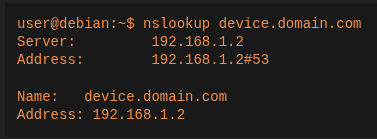

On my current debian desktop I executed nslookup of one of the domains programmed into piholes local dns records section.
The results it gives are for server and address values that it shows for the FQDN i queried.
The server value says the dietpi OS LAN IP address and address value is also the dietpi LAN IP, but it adds port 53 at the end of it.
pls can you share what you see?? I guess you misread the output.

root@DietPiProd:~# nslookup dietpi.com
Server:         9.9.9.9
Address:        9.9.9.9#53
Non-authoritative answer:
Address: 188.114.96.3
Address: 188.114.97.3
Ah, the preformatted text usually works, but I’ll keep that in mind moving forward.
ok back to topic.
The first two lines, server and address are the information for the DNS server used. It has nothing to do with the domain you are looking for.
This information is provided below. After the name of the doamin you see the IP address provided by the DNS server. Ok this is pointing to your dietpi device as well. That’s good.

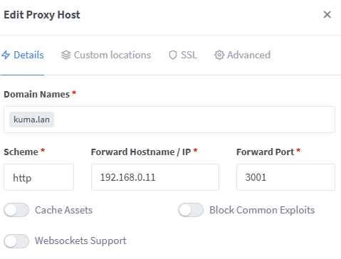

Next in line will be NPM. How did you setup your proxy host entry? For me I use IP address of the target like this
When editing the proxy host, I use the LAN IP of the device and the service’s port number. I’m familiar with this from using Nginx on my NAS, but after switching Nginx to DietPi, it’s not receiving requests, and I’m unsure why.

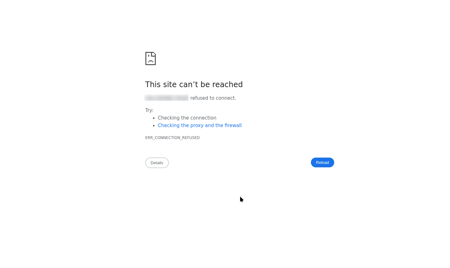

where do you know this? What happen if you try to reach your FQDN on a browser?
I see this for every FQDN I try.
