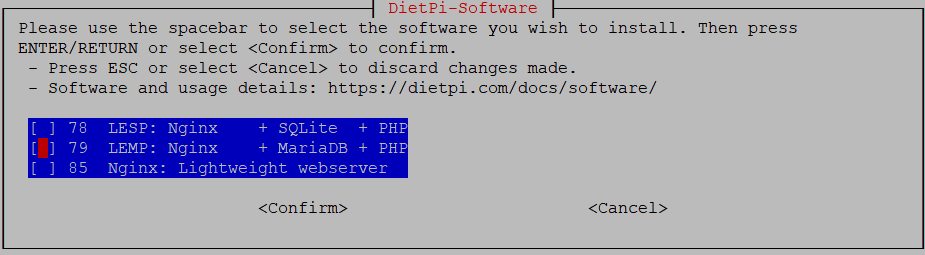

but when checking in the dietpi-software list, it wasn’t actually listed as installed:
What’s the difference with the ps command entires and the non-installed dietpi-software (85)?
Is one default system (and not able to be un-installed) and other is a 2nd install (if installed)?
What would happen to the ps listed one if installing from the software list (85), and/or apache, or some other via apt etc?

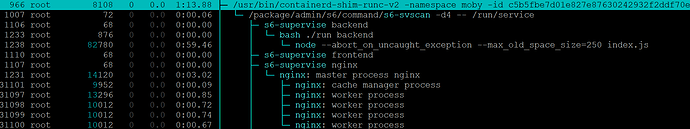

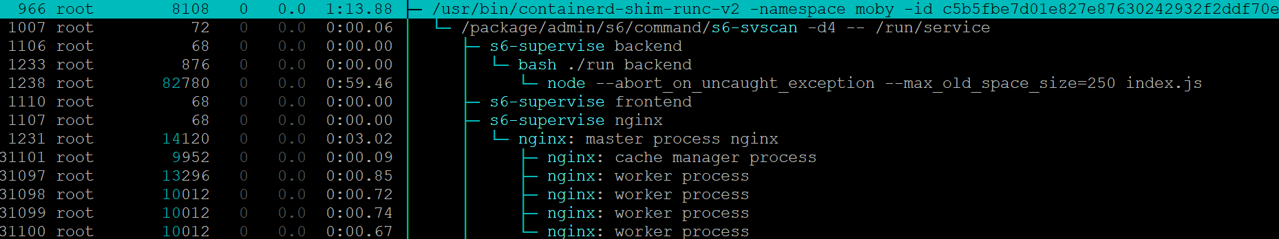

Did you install Docker??? You can run htop to see where the process is coming from. From our side, we don’t install a web server by default. It should have a different reason.
yes, docker is installed with several containers that use webpages for access - (they’d use their own webservers i guess, nginx could be use for them).

Using ps will show Nginx processes from inside the Docker container as well.
As you can see on the following example, Nginx processes are created by the containerd process. Means, they are created by Docker and running inside the container.

good call, yes htop will check within containers.
