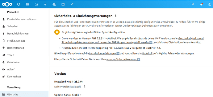

Hey Guys,

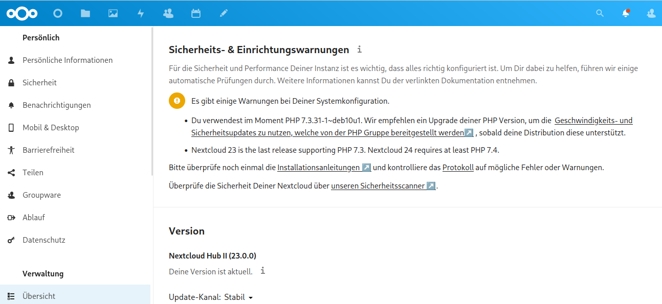

after some weeks without any Problems today I decided to update Nextcloud to actual Version 23. In the Security Warnings Tab it then suggests to update PHP to Version 7.4. Is it recommended to do this manually and how can I do this? Or should I wait for upcoming DietPi-Updates? Thanks a lot.
You are running Debian Buster as far as I can see. Therefore PHP7.4 is not available on a standard setup. You would need to update to Debian Bullseye if you like to switch to PHP7.4

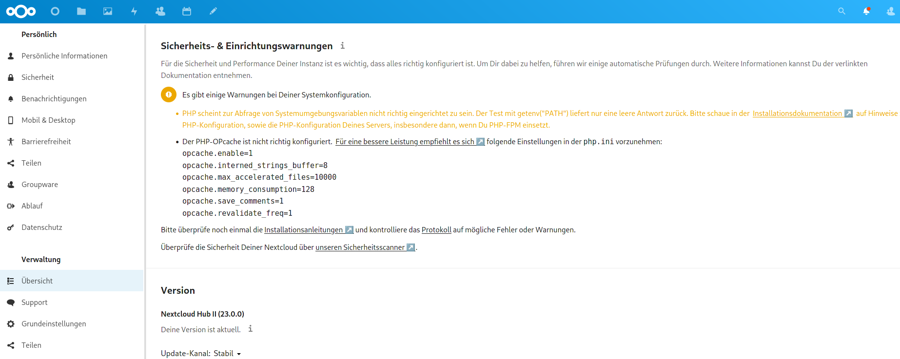

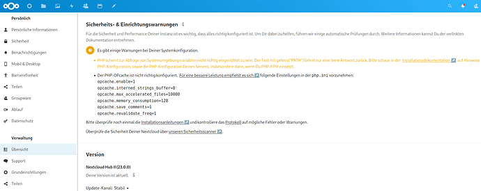

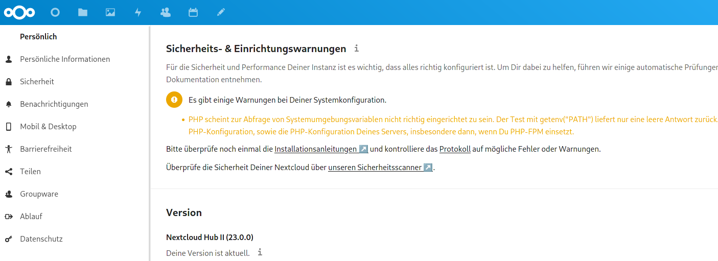

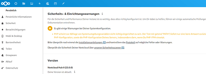

Thank you very much! Today I have managed to upgrade from Buster to Bullseye, using your Tutorial. When I log into the Nextcloud-Webinterface under “Overview”, I see then a few Security Warnings. Can you please assist me with this? I wish you and all of your polite Team a merry Christmas.
yes we noticed this as well. A fix will be done on upcoming release https://github.com/MichaIng/DietPi/pull/5109
As a workaround you could perform the adjustment yourself in /etc/php/7.4/mods-available/dietpi-nextcloud.ini
Can I do this simply by inserting opcache.enable=1 etc. into this File?
My File now looks like this:
; Nextcloud PHP settings
; priority=98
memory_limit=512M
opcache.enable=1
opcache.interned_strings_buffer=8
opcache.max_accelerated_files=10000
opcache.memory_consumption=128
opcache.save_comments=1
opcache.revalidate_freq=1
apc.enable_cli=1
have a look to the file what values are set already. At least the issue we discover is the value opcache.memory_consumption=128

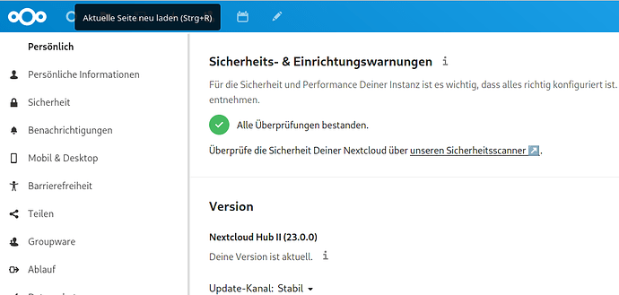

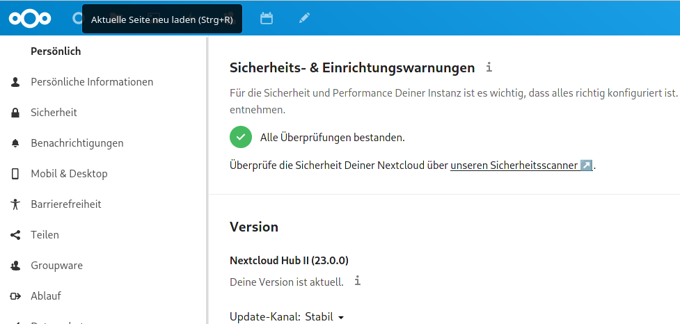

For those who are interested: I edited another File, and now all is working as it should:
opcache.memory_consumption=128 is sufficient indeed. Due to a bug it isn’t added with current DietPi release, fixed for next release.
