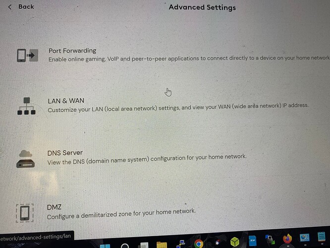

I only have this option Before it was working for my odroid xu4 80/443 , For example after i install dietpi - nextcloud , 10.0.0.58 local ip it works i can load the nextcloud setup page , and then port forwarding 80/443 , then i enter my IP ( not local ip ) 24.xx.xx.xx/nextcloud it suppose to load the nextcloud page like local ip before i setup dns but now it’s not working anymore .
Since i read some shaw customer i found out shaw start blocking 80/443 , here is the like below :
if you go for the edit button`on the xu4 entry, how does it looks like?
That is the edit page with add port forward button
can you share a picture of the options available?
There is not too much option/setting in stupid shaw bluecruve modem , and also they starting to block 80/443 this year
