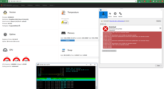

I’ve been using my nextcloud setup on RPi3(the latest DietPi distro, wifi connection, temperature controlled fan via pigpiod)+usb hdd (with direct power line to PSU)+2.5A power supply over a year with great success. The speed was around 1-2MB/s. Recently, I’ve switched my RPi’s wifi to the ethernet connection to my router. To test it, I’ve synced 26Gb over LAN and it got frozen during the sync. RPi Monitor still works, ssh works and htop shows that my CPU is not totally busy after I’ve got nextcloud service to stop syncing. This looks weird.
Then I’ve changed the ethernet speed to 100Mbits/s halfduplex and tried the same test again with 11Gb of files. The same thing happened, so it is not the bottleneck of RPi’s USB bus.
Please, help me investigate this case. What logs do you need?

Apart from nextcloud I have only RPi-Monitor as you can see in the screenshot I posted before. And I have my own python script using pigpiod library to control the fan. Nothing else is installed here.
About the timing of the crashes - I didn’t measure it, but the nextcloud is having a hard time preparing for syncing big files, probably, it calculates the files hash sum.

I’ve tried to replicate the problem and I’ve noticed:
Nextcloud gui on PC at the beginning of the 3.5Gb file transfer gets stuck for a while. Then it throws Connection timeout error. 1Gb-1.5Gb files gets stuck for a while but copies just fine after that.
