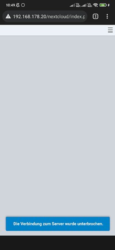

My nextcloud collabora CODE Server arm 64bit doesn’t work on my Raspberry Pi 4 4gb I use Dietpi 64bit. Whenever I create a file and try to open it, I get the Server not found message.

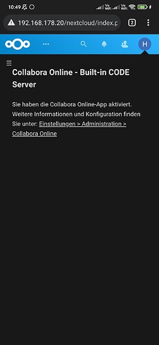

Have a look at the your last screen shot posted. :wink:
on the last screenshot you can see that the server works but it doesn’t.
Well there as well is the radio button to change to your own server :wink:

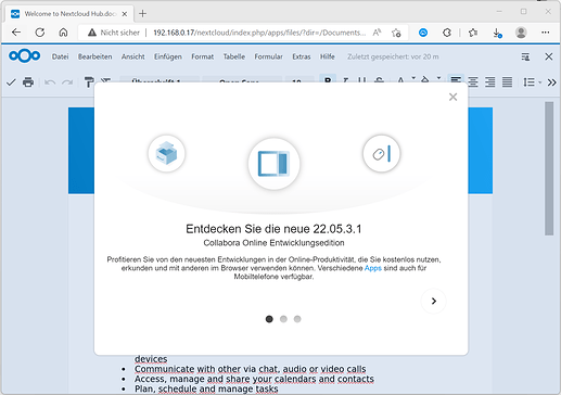

I just activated Nextcloud Office and the Collabora Online - Built-in CODE Server (ARM64). Once installed, I selected Collabora as local Collabora Online-Servers. Done.
