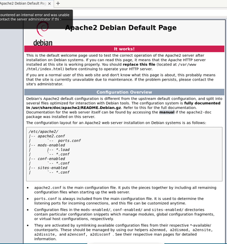

Please note, since this post I’ve removed apache2 and Nextcloud, then reinstalled them. I now get the correct Apache2 page:

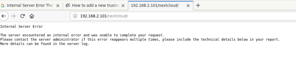

BUT, when I use the default Nextcloud subdomain, which in my case is 192.168.2.101/nextcloud, I get the following:

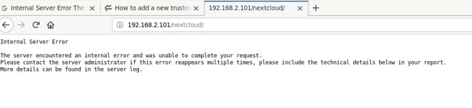

Even weirder, it used to show a plain text file, specifically “public.php” located in /var/www/nextcloud/. This was before I wiped php and reinstalled it:

Yeah something seems to have mixed up with prior Nginx install. The raw PHP file view indicates that PHP was not running correctly, e.g. the Apache PHP module missing.
Possible path:
  1. Nginx installed, which installs php-fpm
  2. Nginx uninstalled, but PHP left
  3. Apache installed, which did not (re)install PHP, since it was installed already
  4. Apache requires libapache2-mod-php and not php-fpm, hence no PHP used by webserver.
I’ll need to dig into the code, as any webserver install should at best reinstall PHP as well to guarantee that Apache gets its PHP module, respectively Nginx and Lighttpd get php-fpm. The other PHP implementation should instead be removed vise/versa.
