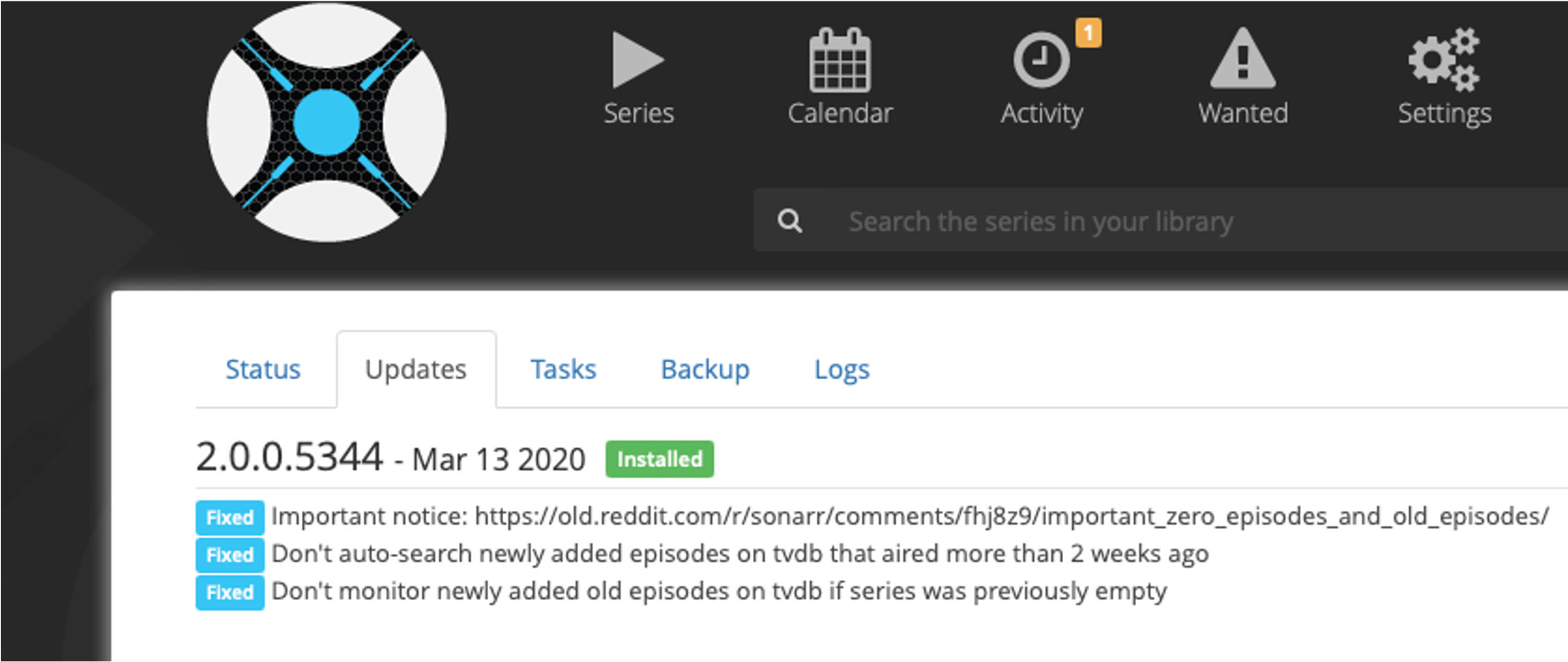

I use sudo apt update. I also just added a print screen in the initial post. Thanks!
for Sonarr and Radarr you can check inside the WebGui for updated. usually you should be able to click and install update from there.
Yeah, usually it does but not on my install… see attached
I see that Radarr by the way has a recent date… I thought it was an older version somehow. Well, then it’s just Sonarr not updating…
Edit: solved. Dietpi doesn’t include V3 yet… I upgraded following this post https://dietpi.com/forum/t/sonarr-v3/3856/1
