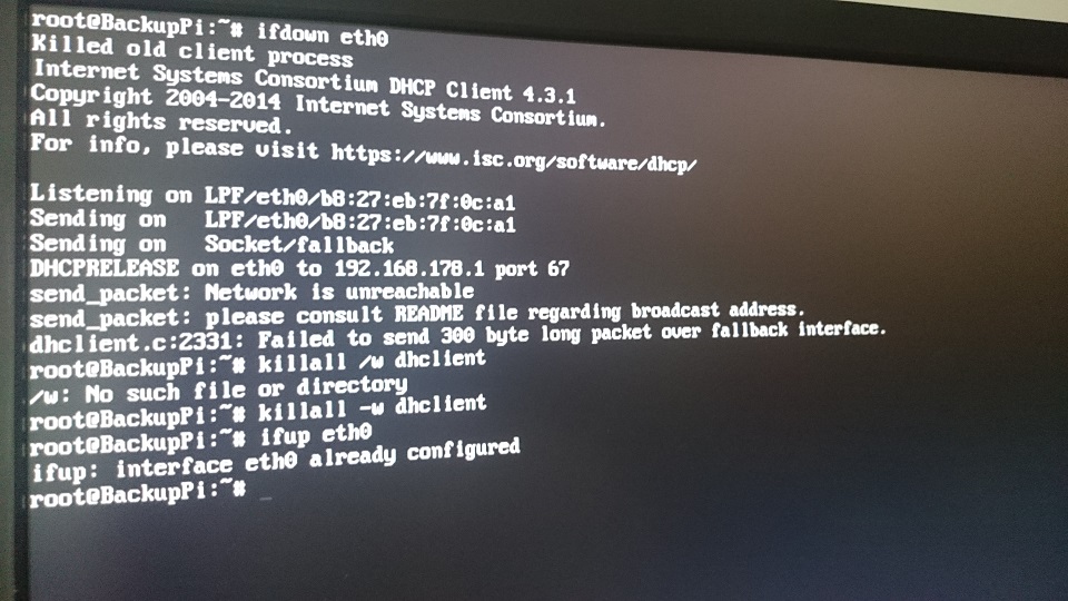

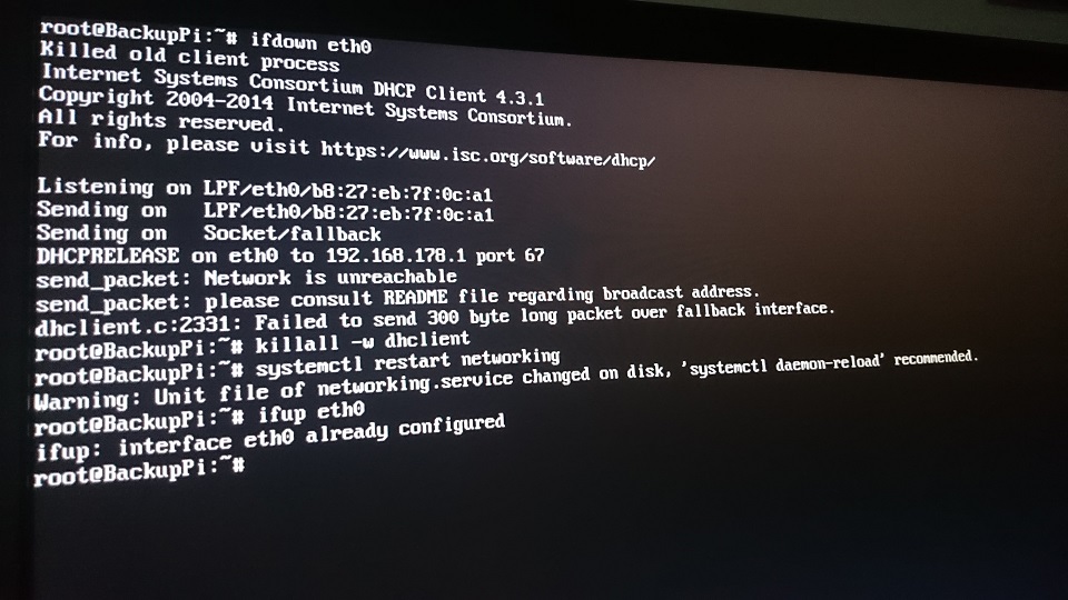

I’ve tried your steps but I still don’t know what the problem is. Maybe you can see something in the screen shot.
Thanks.

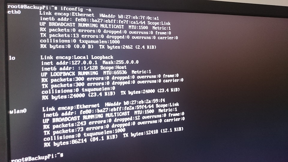

Need some more info. After a fresh reboot, can you take pictures of the following:
ifconfig -a
ifdown eth0
killall -w dhclient
ifup eth0
ifconfig -a

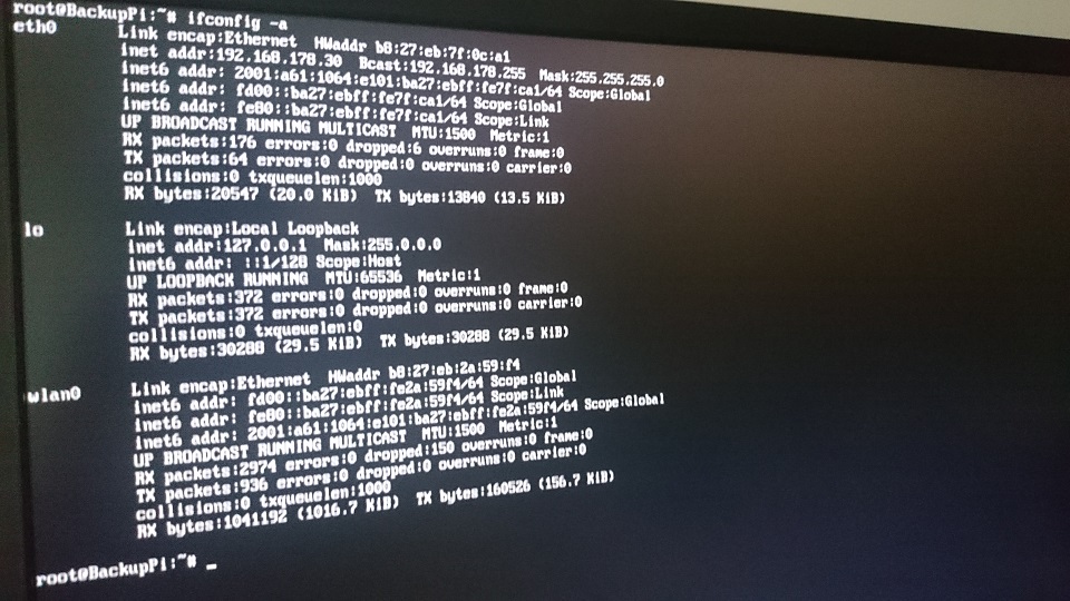

Please see the attached screenshots. This time the ethernet connection was repaired after executing your commands. But it does not seem to work all of the time. You can see the configuration before in 1.jpg and after in 3.jpg (the attachements seem to have the wrong order in the forum).
Yes I have tried a different network cable and the pi is directly connected to the router. My router and internet provider already have full IPv6 support in addition to IPv4 in case this does matter. This pi has wifi but it is disabled in the DietPi configuration.

It looks like the WiFi connection is still active, lets try and disable it again:
/DietPi/dietpi/func/dietpi-set_wifi_bt wifi 0
reboot
