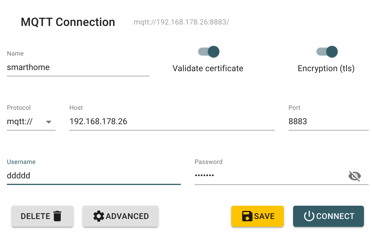

But when I try to connect to my mosquitto server with this certificates
I get the error
What is wrong?
