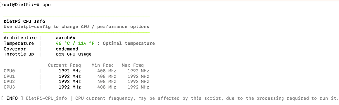

As you can see based on the screenshots, conservative runs well below max frequency but both schedutil and ondemand stay at almost max level.
My concern is, given the lightweight programs I am running, should they always stay at almost max levels with ondemand or schedutil governor? Or is conservative not enough for the programs I am running?

My guess is, that the cpu script itself will raise the CPU frequency earlier when it’s used with the ondemand and schedutil governor. As it says in the perfomance options, the conservative governor will scale much slower, the clock speed will stay longer at the minimum until it’s clocking up.

Indeed the cpu command itself may be responsible for the load.
  • ondemand is meant to immediately max CPU frequencies when a certain load has been reached, 50% by default on DietPi. 50% can be reached quite quickly on 408 MHz. This inefficient behaviour is the reason why schedutil is the default on DietPi, the modern succesor.
  • schedutil uses information from the CPU scheduler itself, that way skipping a dedicated governor layer, to dynamically adjust CPU frequency, using all available pstates instead of just min and max. So you see those various different frequencies each core.

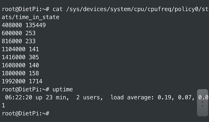

Thank you for the clarification. Correct me if I’m wrong, but it does seem lower frequencies are active more than the higher ones.
Below is a screenshot with schedutil as governor ~20mins after reboot.
Though I do hope the cpu command will display results better.
Thanks again for the clarification!
As you can see, it is on lowest frequency about 98% of the time. It is on higher frequencies for a very short time when you run interactive shell commands, like cpu itself.
