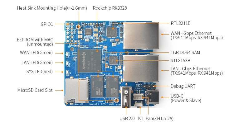

You need access the GPIO pins, i.e. open the metal case, in case. Between the Ethernet ports and the USB-C port, there are the 3 pins of the debug UART, which should be labelled so you can attach the UART adapter correctly:

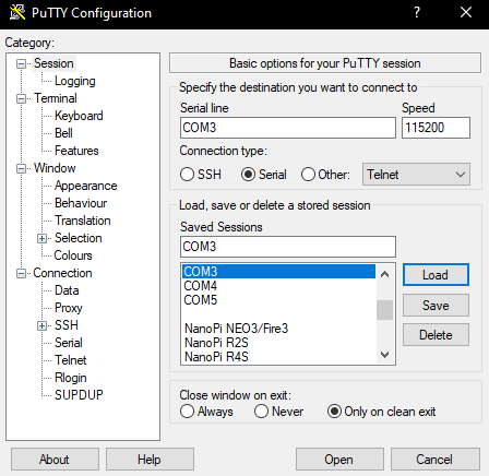

Attach the other end to a PC. PuTTY is not only a SSH client, but also supports serial ports. The console should appear as COM3 port, so in PuTTY switch to “Serial”, enter “COM3” and 115200 baud rate:
putty
Open it and then power the R2S. You should see early boot messages from bootloader stage, kernel logs and in the end a login prompt, depending on where it stops, respectively the step/reason where it crashes/hangs.
