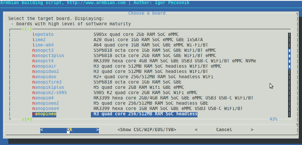

NANOPI M4 build from Armbian build tools to install Dietpi
Build a basic system with armbian build tool, you can select Nanopi M4 as build choice minimal to install Dietpi with the installer script.
No errors so far and hardware works i think, now i have soundcard options, i will further test all the hardware the next days and keep you informed.
I think i have the solution for 100% working Nanopi M4 system! :sunglasses:

All hardware seems to work wel using this method, and with the armbian prebuild image gotproblems using the dietpi installer script, and with that build script for armbian you can make a minimal terminal based system with all the hardware drivers, in the past i got errors and hardware trouble with armbian prebuild image.

With the Armbian build tool you can choose your single board computer brand to build, if i am not wrong even the NanoPi NEO4, and then you choose to build a minimal terminal system and write it to microsd card en start the dietpi script on it. and that image is just part of the list!
