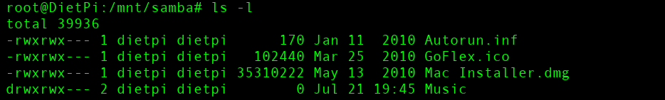

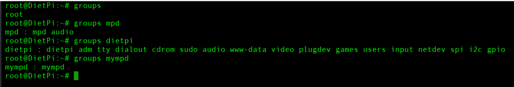

Now we have ownership issues.
Dietpi owns the samba drive
MPD is the user for MPD therefore I can’t connect to the music unless I change user to dietpi or root
But if I change the MPD user to dietpi or root, mympd doesn’t connect to MPD
