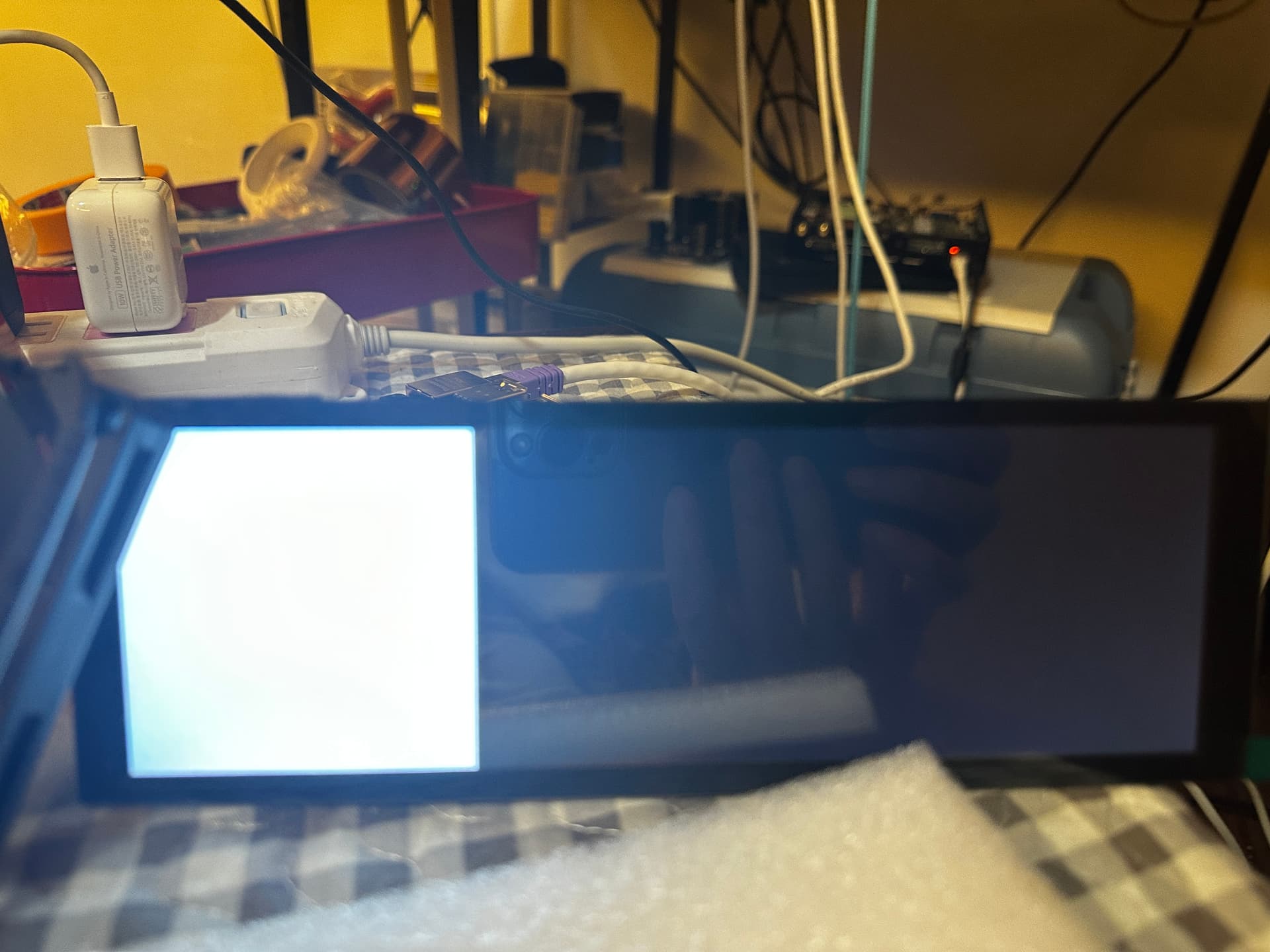

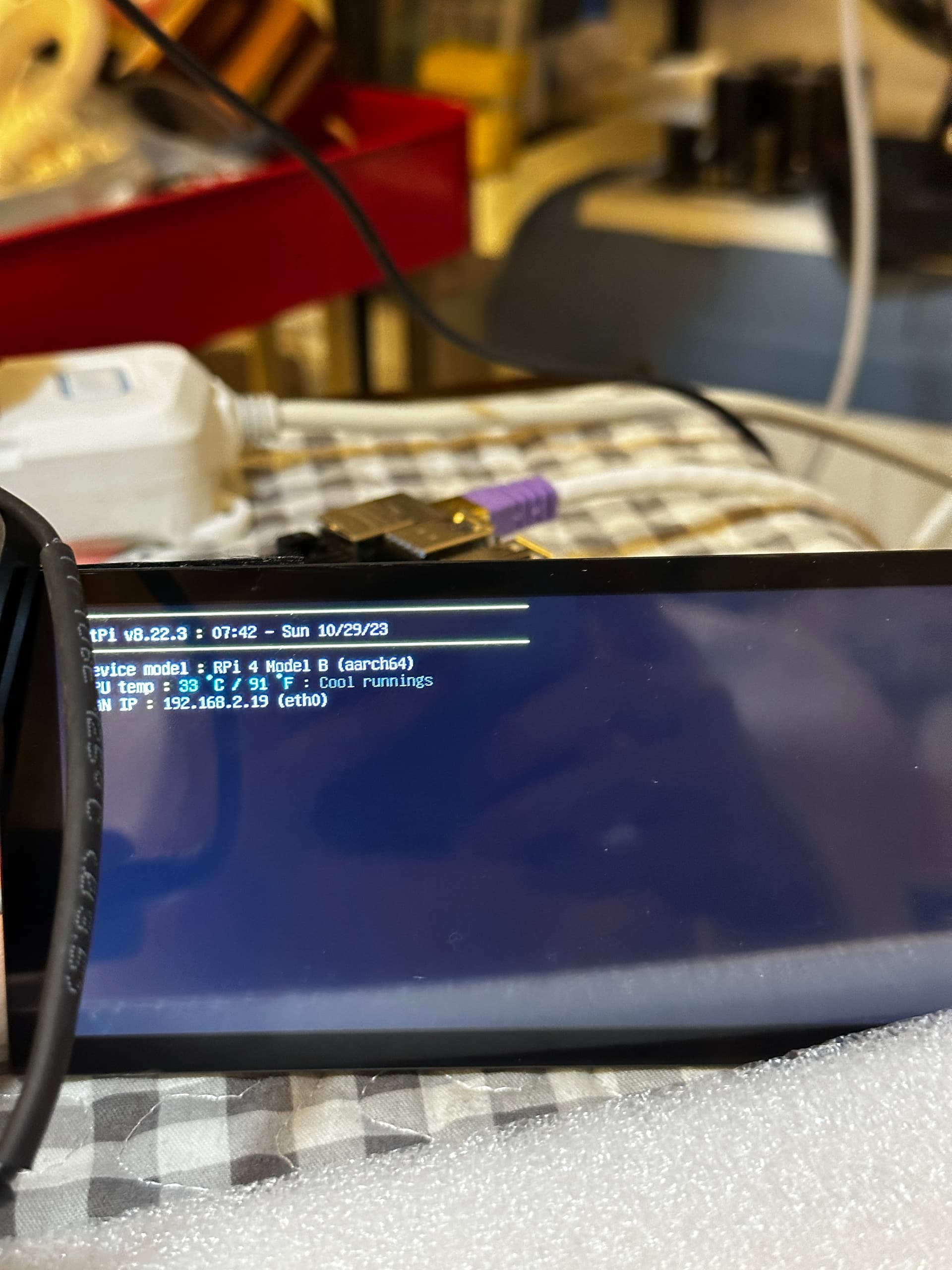

My DSI 7.9-inch screen driver and resolution are normal at boot, but the Chromium-browse does not display normally
I installed Chromium-browser under DIETPI, and now my DSI 7.9-inch screen driver and resolution are normal when I boot up, but the Chromium-browser interface is not normal. How can I set him to follow the same resolution and direction after boot up, please help me thank you
