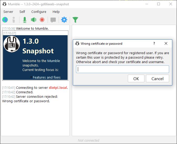

I am unable to login as a SuperUser to properly setup rooms etc on my server. I can login as a registered user just fine. Can only create temporary rooms etc. which disappear as soon as I move or log off.

I only get the error if I try to login as a SuperUser. If I dont want any channels this works fine. However I want customized channels similar to my TS3.
What am I missing?
