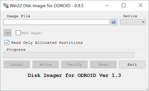

I went with the DiskImager for Odroid way, but I can’t seem to be able to make it read the shrinked partition only.
It reads the whole card.
What am I missing? It actually looks like the “normal” Win32DiskImager to me.
Sorry, I possibily gave wrong link, I’ve uploaded one i’am using:
INVALID LINK REMOVED
Make sure box is ticked, then read image:
Yep, this is the correct one. Thanks!
