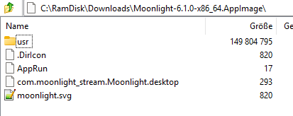

Fun facts: AppImages are compressed archives with a common Linux root filesystem structure/overlay inside with the needed data and libraries etc. Instead of being extracted to the host OS (which would be perfectly possible), or executed in an insolated/sandboxed environment via container engine, the contained filesystem is mounted to /tmp, and then just executed pretty normally with a fixed AppRun executable, which is a symlink to the actual moonlight executable within the directory tree:
root@VM-Bookworm:~# ls -Al /tmp/.mount_Moonli0feN0l/
total 1.0K
-rw-r--r-- 1 root root 820 Sep 17  2024 .DirIcon
lrwxrwxrwx 1 root root  17 Sep 17  2024 AppRun -> usr/bin/moonlight
-rw-r--r-- 1 root root 293 Sep 17  2024 com.moonlight_stream.Moonlight.desktop
-rw-r--r-- 1 root root 820 Sep 17  2024 moonlight.svg
drwxr-xr-x 7 root root   0 Sep 17  2024 usr
There is a regular Linux desktop launcher (.desktop entry) included, not sure whether/how it is used, or whether it is even part of the AppImage specification, since it does define a non-standard attribute:
X-AppImage-Version=6.1.0
