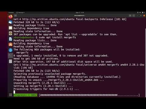

so i googled for a youtube tutorial and followed this:
but i didnt manage it to work (i started from the mergerfs installation, because i prepared all my drives with dietpi_drive_manager and not via command line)
