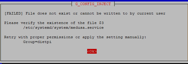

All double dutch to me.
Posted above ^
Is there anything I can do my end to make it work or is it a case of sit back and wait (np if it is, these things happen after all)
hmm ok can you try reinstall Medusa. At least you have a different error message I would expect.
dietpi-software reinstall 116
 sudo dietpi-software reinstall 116

pls try
G_CONFIG_INJECT 'Group=' 'Group=dietpi' /etc/systemd/system/medusa.service
systemctl daemon-reload
systemctl restart medusa.service
systemctl status medusa.service
without sudo
with sudo:
dietpi@DietPi:~$ sudo G_CONFIG_INJECT 'Group=' 'Group=dietpi' /etc/systemd/system/medusa.service
sudo: G_CONFIG_INJECT: command not found
dietpi@DietPi:~$ G_CONFIG_INJECT 'Group=' 'Group=dietpi' /etc/systemd/system/medusa.service
dietpi@DietPi:~$ sudo systemctl daemon-reload
dietpi@DietPi:~$ systemctl restart medusa.service
Failed to connect to bus: No such file or directory
dietpi@DietPi:~$ sudo systemctl restart medusa.service
dietpi@DietPi:~$ sudo systemctl status medusa.service

journald.conf  network        system       timesyncd.conf  user.conf
logind.conf    resolved.conf  system.conf  user
I dont know enough about linux to find the correct link to the file though
EDIT:
so the file is there, from what i can see
dietpi@DietPi:/etc/systemd/system$ ls
ok I missed sudo as I’m doing all this as user root :wink:
pls can you post following
systemctl cat medusa.service
groups medusa

not sure if that helps?
the first command seems to do the same as loading it into nano:
dietpi@DietPi:/etc/systemd/system$ sudo systemctl cat medusa.service
second command:
dietpi@DietPi:/etc/systemd/system$ sudo groups medusa
medusa : dietpi
Side note: The help getting this sorted is appreciated
ok somehow the user group did not changed
[Service]
User=medusa
Group=medusa
it should be
[Service]
User=medusa
Group=dietpi
pls try again to do this as user root
output should looks like this
root@DietPi3:~# G_CONFIG_INJECT 'Group=' 'Group=dietpi' /etc/systemd/system/medusa.service
[  OK  ] G_CONFIG_INJECT | Setting in /etc/systemd/system/medusa.service adjusted: Group=dietpi
root@DietPi3:~#
I always thought sudo was to do a command as the root user, after reading your reply I found out thats not really the case…
A quick bit of googling and i learnt how to log in as root user.
now the config_inject thing worked and i can load medusa! yay…thank you!
root@DietPi:/etc/systemd/system# G_CONFIG_INJECT 'Group=' 'Group=dietpi' /etc/systemd/system/medusa.service
root@DietPi:/etc/systemd/system# systemctl daemon-reload
