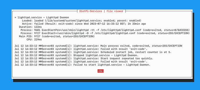

While checking some logs using dietpi-services, I did notice this failure with lighttpd
Would it have anything to do with the nginx 505?

Can you show journalctl -u lighttpd.service

Why did you install 2 web servers at the same time? Of course, that cannot work. Please test the following once
systemctl stop nginx
systemctl restart lighttpd
