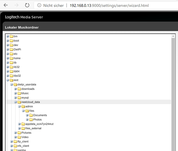

To fix this, we would need to add user squeezeboxserver to group www-data by running following command.
usermod -a -G www-data squeezeboxserver
once done reboot your system and you should be able to see the NextCloud folder on LMS WebUI, like this:
