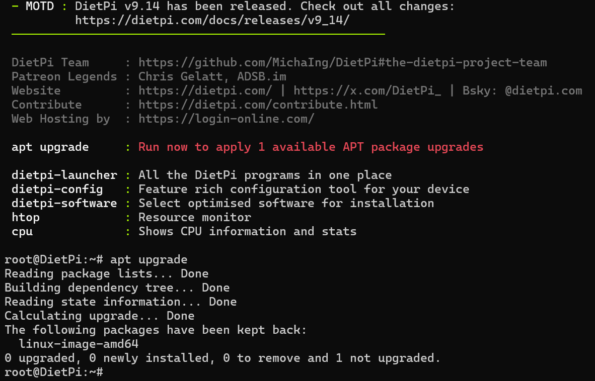

Linux-image-amd64 - The following packages have been kept back
On an NUC PC (Intel) I do get this message: The following packages have been kept back - linux-image-amd64
Never had this message before.
I am running DietPi v9.14.2
Thanks for any help

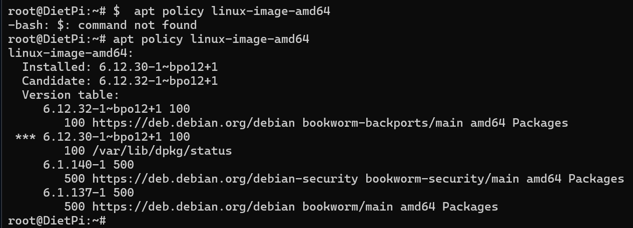

apt policy linux-image-amd64
shows this:

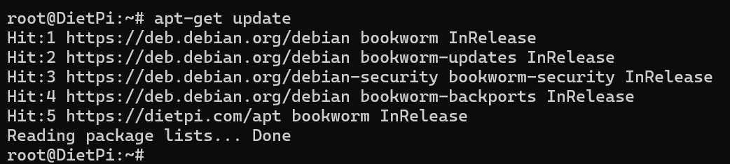

apt-get update
shows
