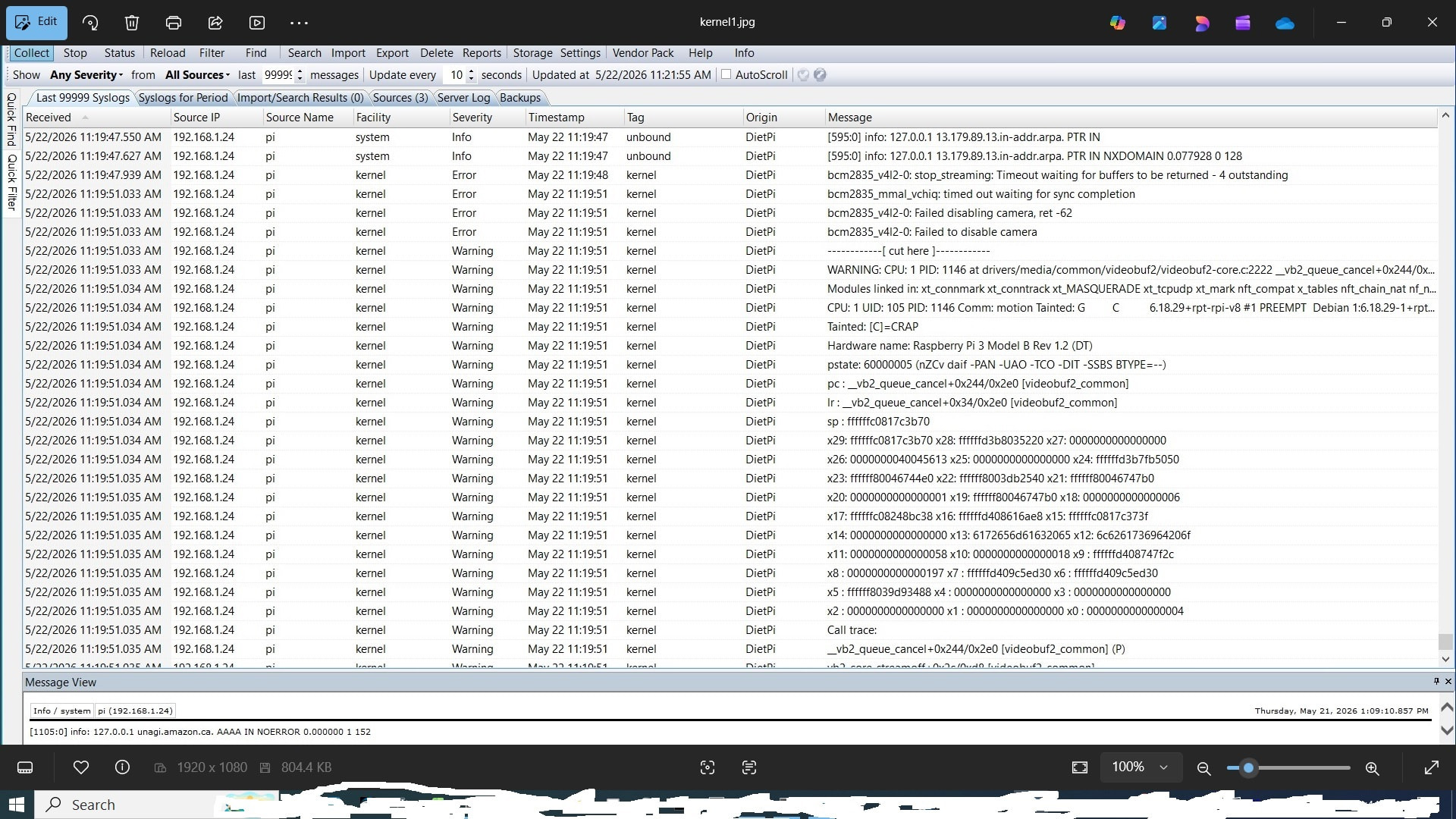

Migrated dietpi from VM to Rpi 3B with pi-hole, unbound , tailsacle & X installed. To make the Rpi Camera V2.1 as CCTV, I installed MotionEye. Everything was working fine.
Then run dietpi-update from V10.3.3 → V10.4.2. Motioneye broke and got the same error msg
"bcm2835_mmal_vchiq: timed out waiting for sync completion".
So does it mean that the following two commands will fix my MotionEye problem.
  1. apt install linux-image-6.12.75+rpt-rpi-v8
  2. cp -p /boot/vmlinuz-6.12.75+rpt-rpi-v8 /boot/firmware/kernel8.img (override)
Thanks,
Roger
It depends on which kernel you’re using. Can you please show the output of “uname -a”?
root@DietPi:/boot# uname -a
Linux DietPi 6.18.29+rpt-rpi-v8 #1 SMP PREEMPT Debian 1:6.18.29-1+rpt1 (2026-05-12) aarch64 GNU/Linux
Thanks,
Roger

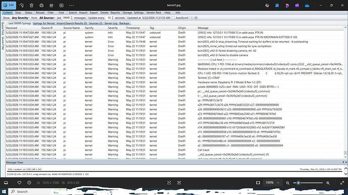

Hi, the old kernel works with Motioneye, Rpi3B camera V2.1. Thanks.
Below is the trace dump 1.
