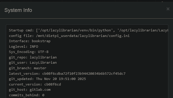

Cool, I installed it and it runs - however it doesn’t update for some reason, so it’s about 114 commits behind the current version at present.
Interesting, the installation script pulls directly from the master branch.
I installed again for testing:

I am running DietPi 9.19.2 on a mini PC with a 1GB NVME boot drive, 16GB RAM, and an Intel N100 CPU. There is no other version of LL running on it. (I used to run it set up manually with DietPi on a RPi5 but I use that RPi for other stuff now, and the aforementioned PC is the only DietPi machine I have now.) I just installed LL from the DietPi-Software list, and did nothing else other than connect it to Prowlarr for indexer sync, and set up the downloaders myself. It is on Debian 12 however, I haven’t upgraded it to 13 yet.

And when you click on “check version” in the LL dashboard, what does it show?
And what happens when you try to update: dietpi-software reinstall 169

I used dietpi-software reinstall 169 and it is now up to date.
