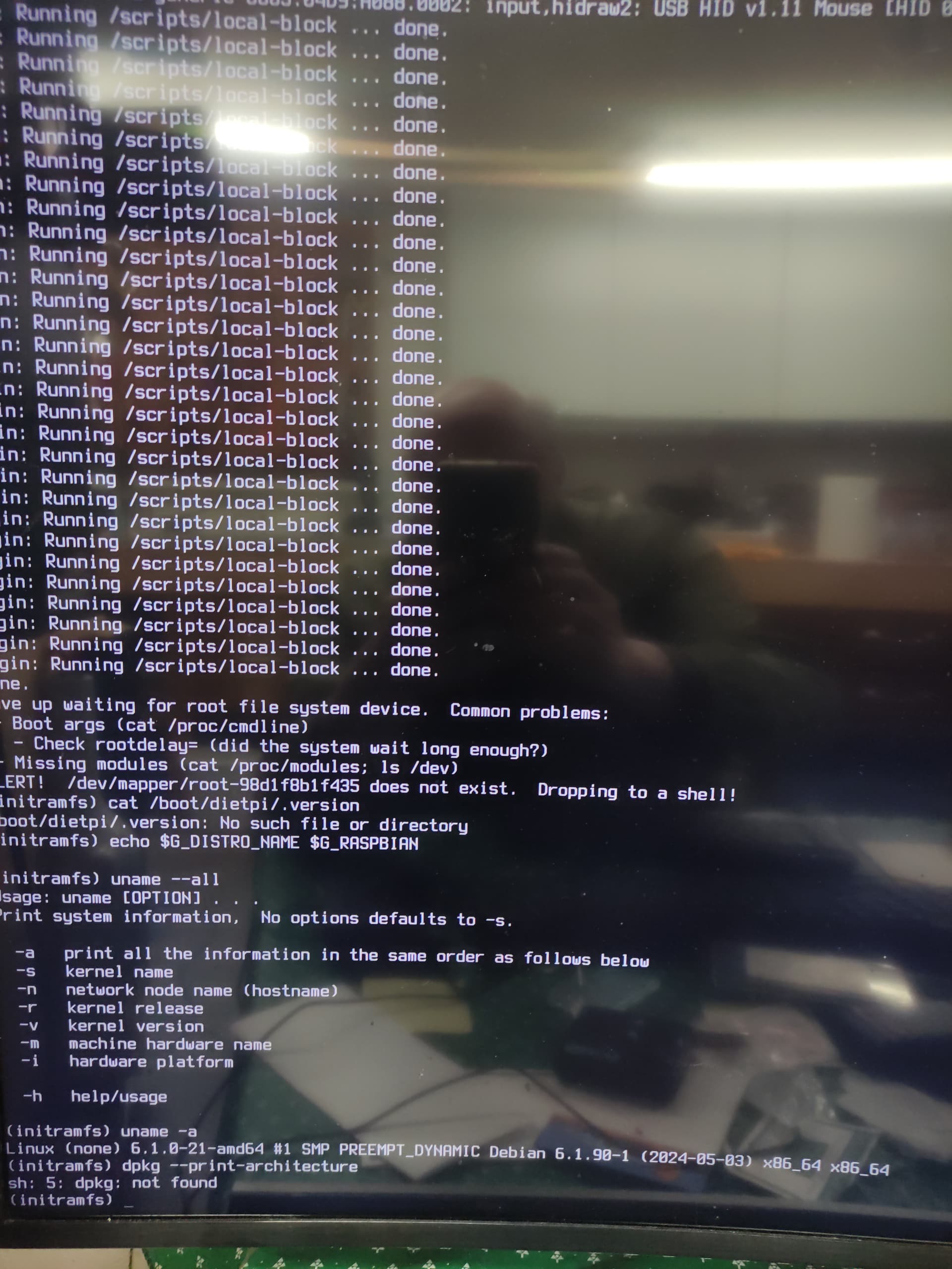

See attached screen shot of failed boot and some commands to display system info.

Attached screen shot shows failed boot.
See attached screen shot.
This looks like the initramfs is missing a driver for root drive controller. Do you have a backup, by chance? Replacing the initramfs /boot/initrd.img-6.1.90-1-amd64 with any previous version should work, so then we could check which module is missing.
Also, from this initramfs prompt you have on the screen, as suggested in one of the log lines, can you show the output of:
cat /proc/modules
This should list the kernel modules embedded in this initramfs. When you get the NUC up with either another initramfs or a new image (it can boot from USB stick?), we could compare this with the modules loaded on the life system:
lsmod
Theoretically a needed driver could have been removed from the new kernel build. Though this would be highly unexpected, or more a mistake then by intention. But can be checked, when we know which driver/module it is.
