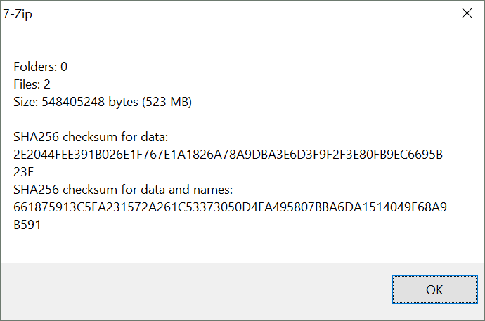

- If you have 7zip, please open the extracted latest image you previously wrote to SD with 7zip, click file > CRC > SHA-256, you should have the same code as:

the checksum is :
checksum
Nombre: DietPi_v133_RPi-armv6-(Jessie).img
CRC-32: ebd25185
MD4: 5749dac5bb734f4904c801ff2774e659
MD5: 4f6dc395a226fa79ac4de54c1798f412
SHA-1: 7040b045adde21f233b8b4c4db595daaba95e97a
Nombre: README.md
CRC-32: 4ff7601c
MD4: de6df2df059cab065fad072435158458
MD5: 80bb006bc9258d11fc504633be95f478
SHA-1: 4868728494d67b7388459b5a08c2a9af18d4c019

Image CRC’s are fine.

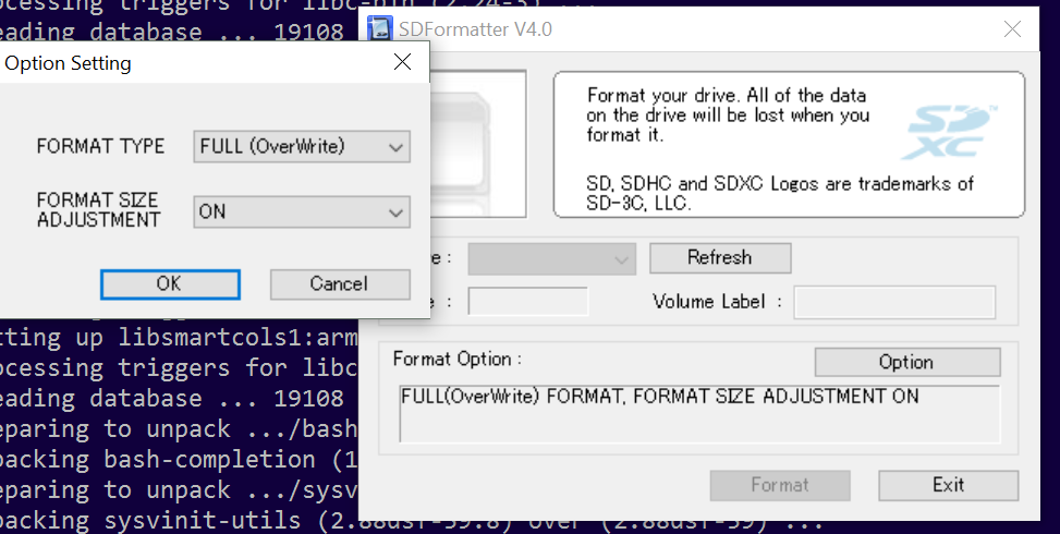

You can some times recover a defective SD card and bring it back to life. Simply by writing 0’s to full card.
Try:
- Download SD Memory Card Formatter for Windows/Mac | SD Association
- Use options as per image below, then click format:
It will write a 0 to every cell/block on the card. Takes a while, but worked many times for me on consistently corrupted cards.
I’ve already fixed, a virus entered the sd card and broke it, so I went out the image of the sd card damaged .However not know if this is Relevate but I see some errors when starting the raspberry. Add a catch below
