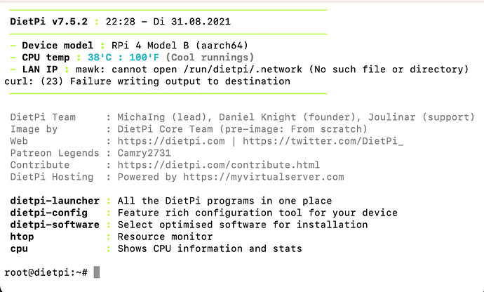

I noticed that i receive the following error, directly after boot:
mawk: cannot open /run/dietpi/.network (No such file or directory)
curl: (23) Failure writing output to destination

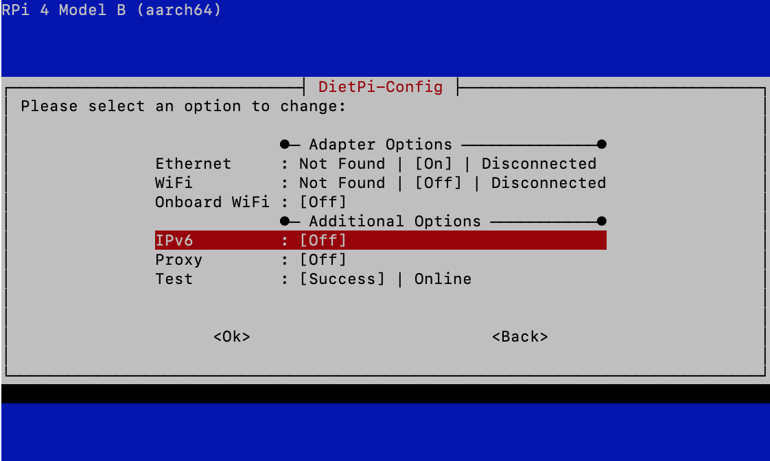

also my dietpi says that i have no ethernet Hardware, but my connection test is okay and i can connect via ssh etc.
