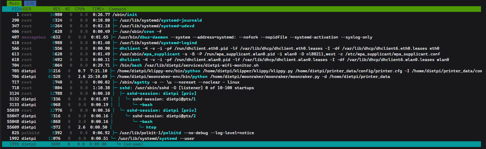

Kiuah was run as dietpi user and NOT as root. So klipper is running as dietpi user.
I added dietpi to the dialout group as suggested by a bunch of other help theads and have logged in and out, rebooted dietpi and the printer.
dietpi@DietPi:~$ id
uid=1000(dietpi) gid=1000(dietpi) groups=1000(dietpi),20(dialout)
