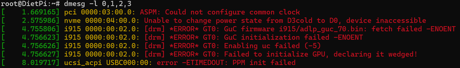

The errors below did show up after upgrade to Trixie (I used the script)
When using:
dmesg -l 0,1,2,3
it returns errors:
[    1.669165] pci 0000:03:00.0: ASPM: Could not configure common clock
[    2.575986] nvme 0000:04:00.0: Unable to change power state from D3cold to D0, device inaccessible`
[    4.755806] i915 0000:00:02.0: [drm] `*`ERROR`*` GT0: GuC firmware i915/adlp_guc_70.bin: fetch failed -ENOENT
[    4.756623] i915 0000:00:02.0: [drm] `*`ERROR`*` GT0: GuC initialization failed -ENOENT
[    4.756626] i915 0000:00:02.0: [drm] `*`ERROR`*` GT0: Enabling uc failed (-5)
[    4.756627] i915 0000:00:02.0: [drm] `*`ERROR`*` GT0: Failed to initialize GPU, declaring it wedged!`[    8.019717] ucsi_acpi USBC000:00: error -ETIMEDOUT: PPM init failed

When running “dmesg” this are errors:
4.755806] i915 0000:00:02.0: [drm] *ERROR* GT0: GuC firmware i915/adlp_guc_70.bin: fetch failed -ENOENT
4.756623] i915 0000:00:02.0: [drm] *ERROR* GT0: GuC initialization failed -ENOENT
[    4.756626] i915 0000:00:02.0: [drm] *ERROR* GT0: Enabling uc failed (-5)
[    4.756627] i915 0000:00:02.0: [drm] *ERROR* GT0: Failed to initialize GPU, declaring it wedged!

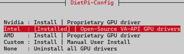

It says installed here:
BUT

Just for clarification,
firmware-intel-graphics is the firmware, the entry in dietpi-config is for the driver. So the firmware was not intsalled, only the driver.

Yes, respectively to install the particular firmware package that is not available on Bookworm yet. The menu shows what has been selected once, and is hence stored as CONFIG_GPU_DRIVER setting in dietpi.txt, instead of checking for the actual DEB packages being installed or not.
I’ll change two things:
  1. When selecting the already installed driver option, it does install the intended packages again, if any missing. So it is not needed to select “none”, have all packages purged and then install them all again.
  2. If the Intel driver was selected, i.e. CONFIG_GPU_DRIVER=intel, the Trixie upgrade script installs the additional firmware automatically.
