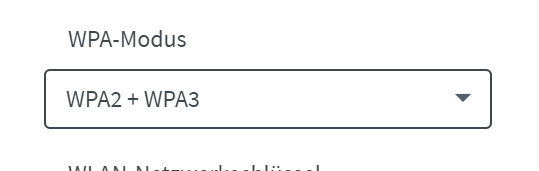

I’m having issues connecting my Raspberry Pi 4 to my wifi network. I have 2 radios, both on WPA2. Screenshot of my openwrt settings below. What settings do I configure for the dietpi-wifi.txt file? Do I have to do WPA-EAP instead? If so what do I fill in? It was minimal setup on my router for WPA2.

My question is how can I connect to my 5.0 band network that now runs with WPA2/WPA3? It seems like only WPA-PSK security works and nothing higher with just using a password

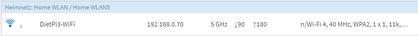

I tested it with my RPi3B+ without issues. I created an unique 5GHz WiFi using WP2/WPA3 and could connect with the RPi using WPA-PSK without issues. The RPi was connected using WPA2.
