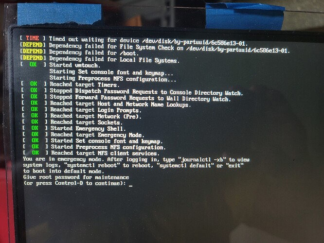

Issue booting. Dependency Failed

  1. Boot the system.
  2. To continue booting you can press Ctrl+D
  • The system to boot.
  • The system is not booting. DEPEND error on File System Check. Please see screenshots.

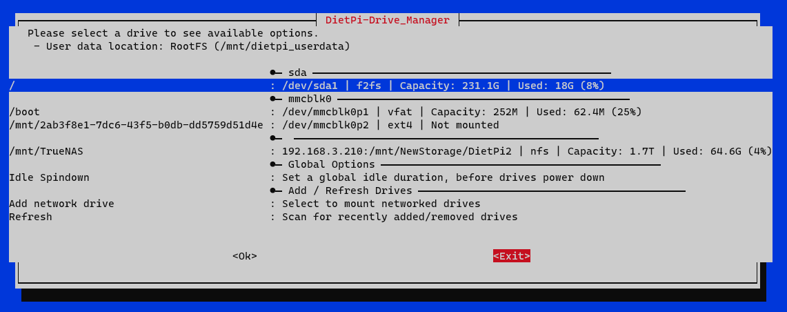

found following in your log
[    2.588715] sd 0:0:0:0: [sda] Attached SCSI removable disk
[    2.849256] F2FS-fs (sda1): recover fsync data on readonly fs
[    2.849694] F2FS-fs (sda1): Mounted with checkpoint version = 5f119016
[    2.849753] VFS: Mounted root (f2fs filesystem) readonly on device 8:1.
Do you have an external disk attached? It looks like this disk is holding your RootFS and has been mounted R/O ??
