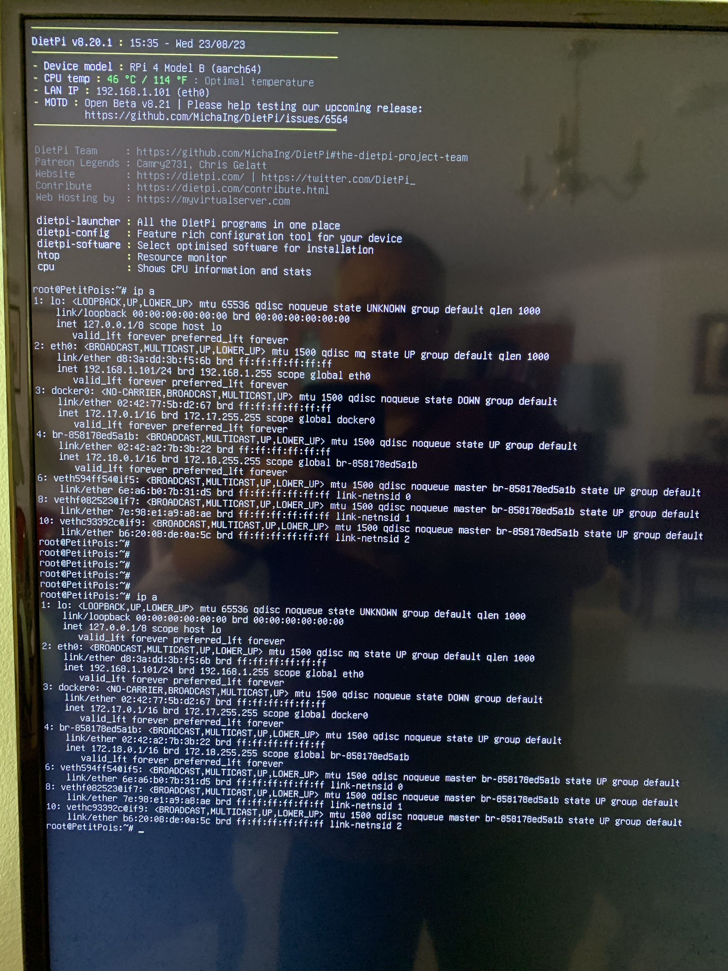

No drive errors, logged in OK and ip a shown. I am now going to reconnect directly to the router and restart. Will let you know…
EDIT:
OK, so it did not survive a restart whilst directly connected to the router, but I did get an ip a this time (the 1st was before the restart, the 2nd after). …it looks like the PI has kept it’s IP, but maybe not too surprising as it is static?

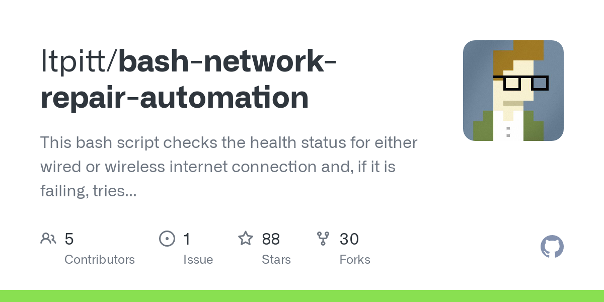

Is there a watchdog script that can try to ping something online, if it fails a few times, then issue a network down then up again?
Here is a pretty in depth script from github where you can set options to either reboot or just restart networking
I am running uptime_kuma which lets me know when it has reconnected after a disconnection. The problem with this particular issue is that it never reconnects - only a full reset address the problem.
