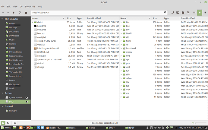

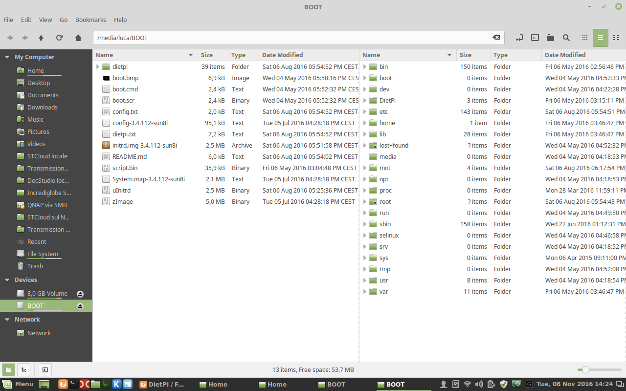

I have dowloaded the image and then installed it on my microsd card with the command (I am using Linux Mint 18 64-bit version):
The image is burned correctly on the card, as the two partitions are created correctly, but when I insert the card in the OPiPC nothing happens.

There’s nothing wrong with your dd command. (If you mount the source-image prior cloning, the output may be corrupt).
As far as I know, the red onboard led is on, when there is a valid boot-image found, otherwise there’s something wrong with card or partitions.
Are you able to mount both SD partitions from your Linux Mint and there’s some boot and userspace content available?
If it looks fine, I’d retry it with another SD, no better idea from here, sorry.

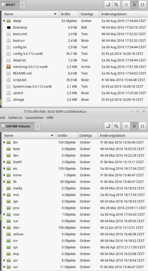

When I mount the dietpi-Opi-image, I end up with two mounted partitions.
One is “BOOT” and one is a device-id that contains the system.
Mine looks different from yours?
You should end up with these two partitions when mounting your SD-card too.
Thanks, mine looks (and looked) exactly like yours.
